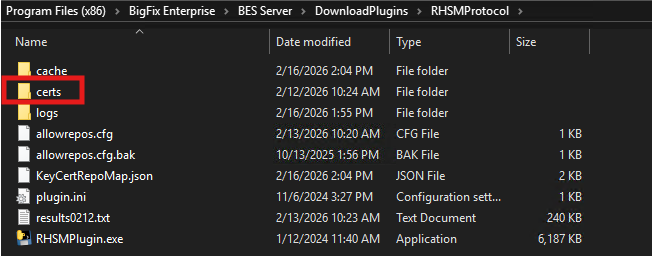

Go to the RHSM portal, create a "system" (We called it BigFix) and then configure your entitlements, and then download the entitle and system certificates. They can be together in one file or separate certificates.
You have to have the Red hat plugin installed as well.
Put your certs in the certs folder of the RHSMProtocol folder.

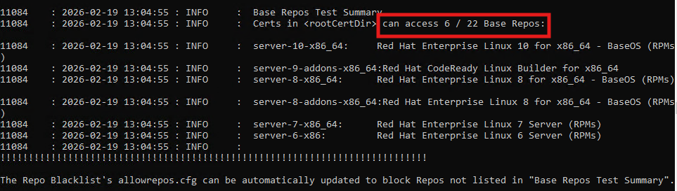

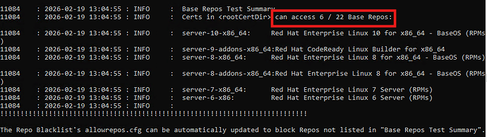

From an elevated command prompt, you can set access and verify BigFix has access to the RH Repos with this command.
.\RHSMPlugin.exe --check-baserepos
Your log output may be long so you may want to save the output, use a redirect like this...
.\RHSMPlugin.exe --check-baserepos >>Output.log
Run the command and you can see if you have access to the REPOs.
You may need to check the log you saved in order to determine the reason a REPO is not accessible.
