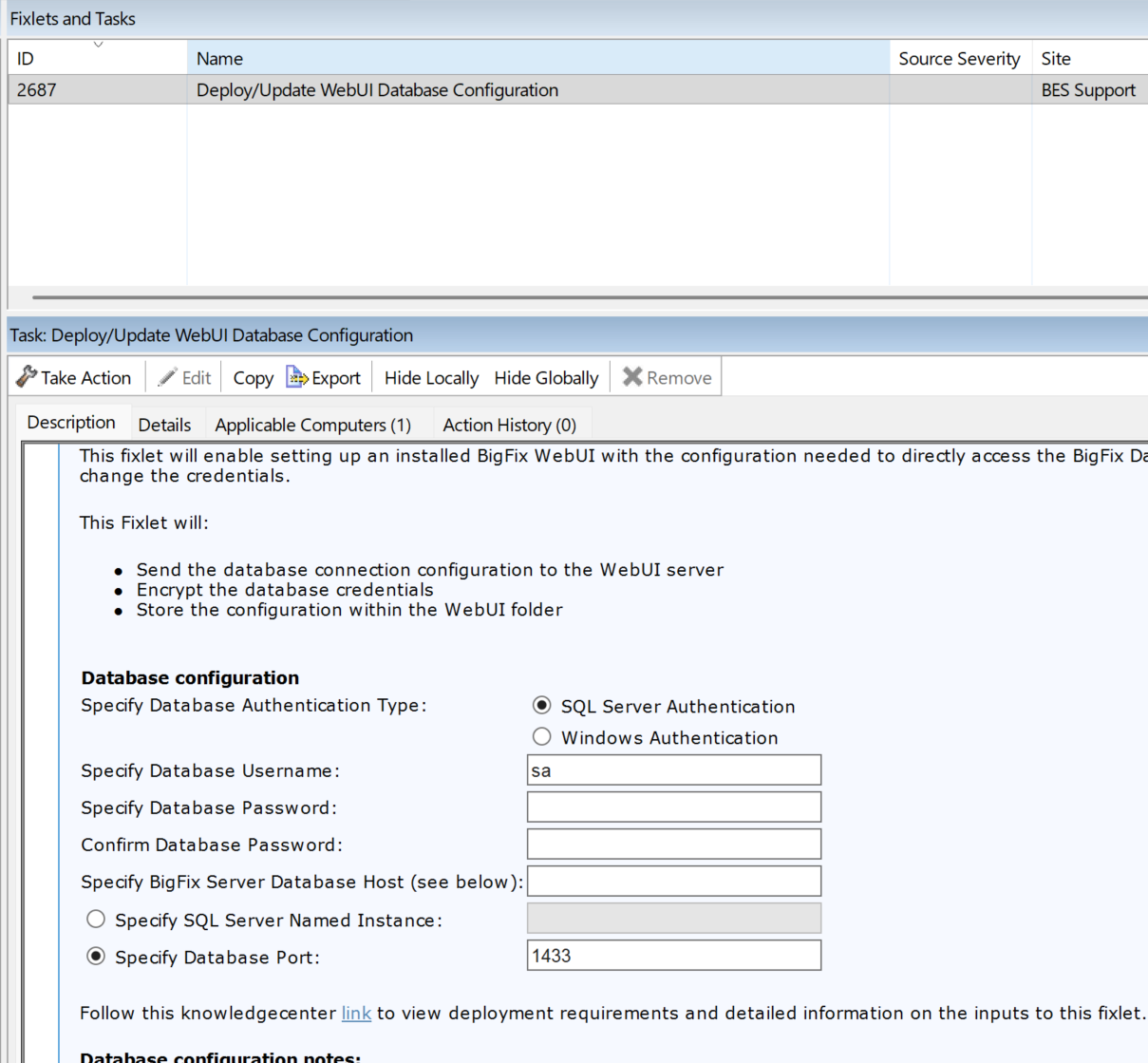

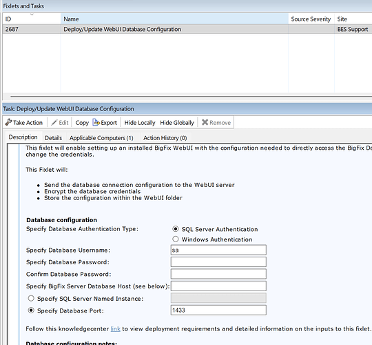

If you're running WebUI, also plan on running the "Deploy/Update WebUI Database Configuration" task from the BES Support site to redirect WebUI to the new database hostname.
