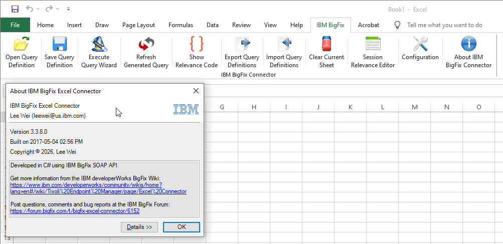

I have always found the Excel Connector a very useful way to build session relevance to use with the APIs (assuming of course you have Microsoft Excel). You can find it on the utilities page. The relevance it creates is scalable and wont have the problems @ageorgiev mentions when using a less complex forms of queries.
Rest API and Webreport not the same result :frowning: - Reporting - BigFix Forum
Have you had any luck getting it to work with Office 365 Excel by chance? I’ve just installed it but see no reference to it within Excel and can’t find any documentation for it.
When I had 365 in my previous employment it was working and my home setup has the C2R version of Office 2019/365 and it worked ok. Just installed on my newer setup with Office 365 build 2603 and all works ok.
I recollect that the 3.3.6 version doesn’t work..needs to be 3.3.8
Thanks! I’ll need to hunt for 3.3.8. Our rep provided me this link and it downloaded 3.3.0.
You should find it on the Utilities section in the Bigfix Wiki
Utilities - BigFix Wiki Wiki
Right you are, thanks again!
