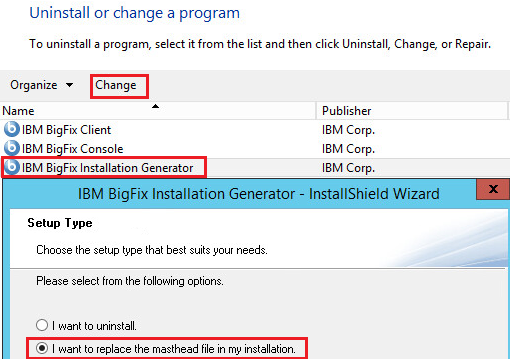

The Clients will update their masthead once they register and gather the latest actionsite, yes. That said, it doesn’t hurt to update the masthead associated with your BESInstallers, and this can be done by clicking ‘Change’ or ‘Modify’ on the Installation Generator in Add/Remove Programs (or Program and Features):
Sounds good, thanks guys!
