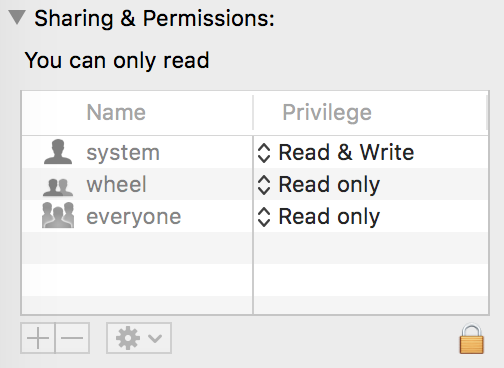

I’m trying to understand what could cause this issue. I’m also curious what the permissions generally are for the plist file: /Library/Preferences/com.bigfix.BESAgent.plist
- What are the permissions set to when they are good?
- What are they set to when they are not?
Command Line example:
Command: ls -l /Library/Preferences/com.bigfix.BESAgent.plist
Output: -rw-r--r-- 1 root wheel 4829 May 17 17:54 /Library/Preferences/com.bigfix.BESAgent.plist
A GUI example:
I don’t actually know if these are correct, but they seem to be and are what is on one of my systems.

Some settings are configured at install time. Others via actions, later. At install time, I believe that our installer wrapper customizes clientsettings.cfg to set them. I don’t believe that we use defaults write to set settings manually as a general practice.
Mac filesystem object inspectors don’t appear to read Unix permissions, so this is harder to answer remotely via Fast Query. Will try to get my hands on one to see.
