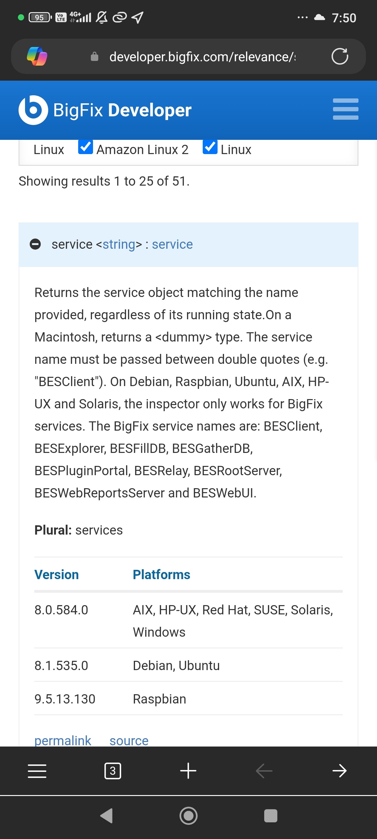

On the documentation, https://developer.bigfix.com/relevance/search/?query=service&platform=aix%2Chp-ux%2Cmac%2Credhat%2Csuse%2Csolaris%2Cdebian%2Cubuntu%2Craspbian%2Ccentos%2Coracleenterprise%20linux%2Camazonlinux%202%2Clinux
This inspector on Linux should only work on BigFix Services.
Are you trying to understand if the Service is enabled or If the process is running?
If you want to check if the service is enabled - please check - Check if unbound-anchor.timer enabled using relevance
There is also an idea to expand the service inspector to all OS: HCL Software - Sign In, welcome to vote.

My system is Red Hat Linux, it is not one of the Linux flavors mentioned in the document, so I still think that the observed behavior is a bug.

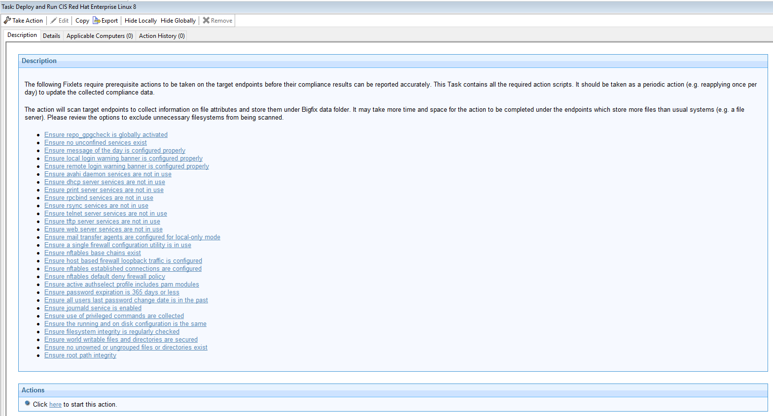

Interesting cause it is not even documented in the “Inspector Changes” of the new version, cause this is significant enough change to allow a ton of Compliance Checks and entire delivery mechanisms to be rewritten, including the complete removal of Compliance “Deploy & Run” functionality which was all based on the fact that client can’t check service statuses, so an action is ran to output statuses to file which then all the service-based checks were using…
