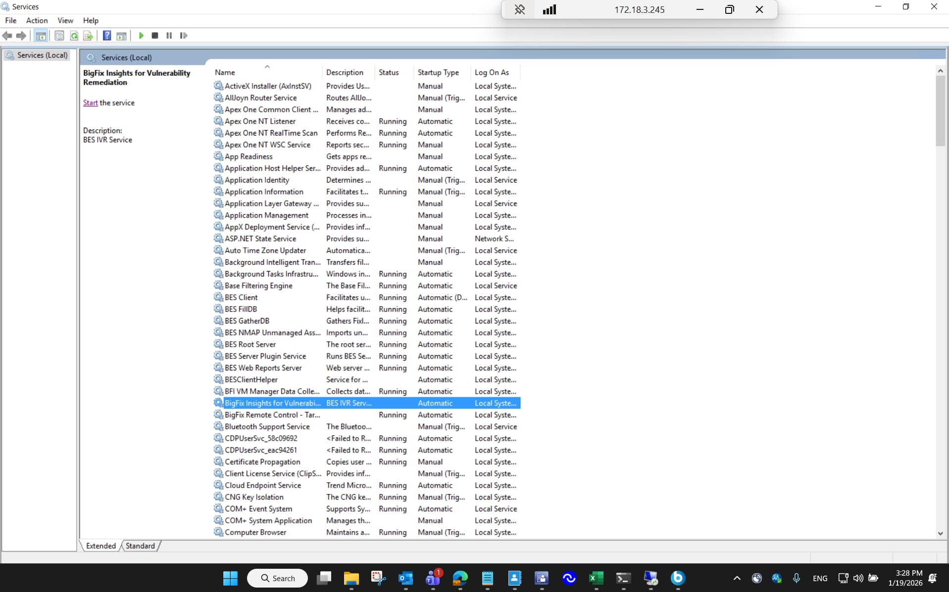

Hi Everyone,
We are currently experiencing a new issue in our environment where the Insights for Vulnerability Remediation (IVR) service is stopped and crashes every time we attempt to start it.
We reviewed the related logs and observed errors indicating that the service is unable to remain running.

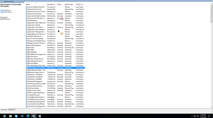

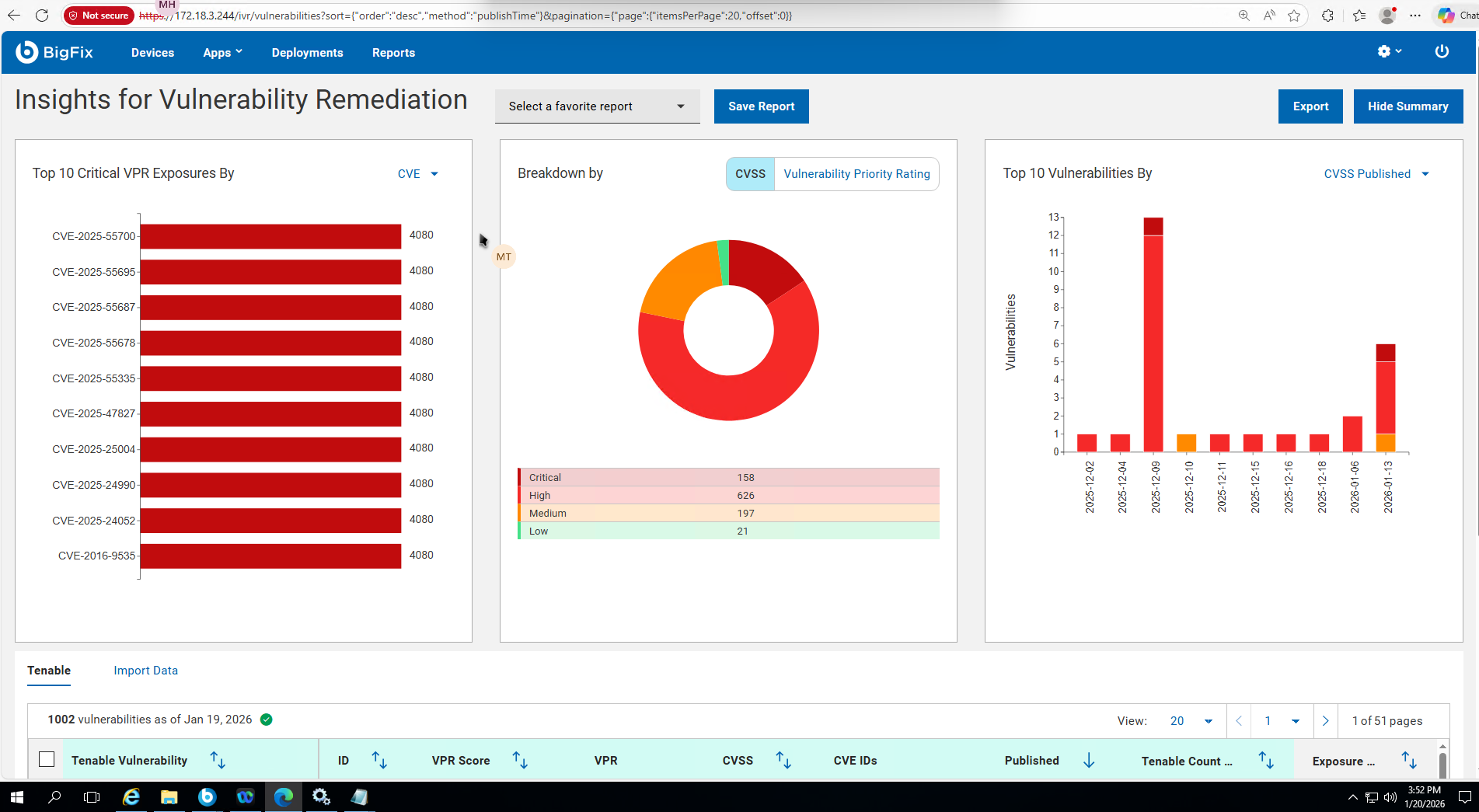

Hi Bro,
I’ve uninstall the service then deployed it again. It’s running now also the import and stuck CVEs data.
