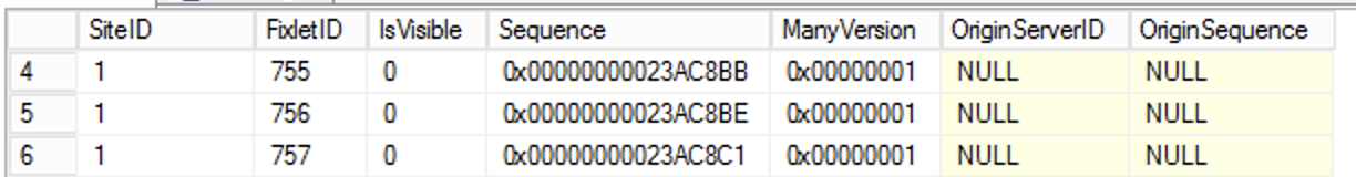

You can put an entry in the FIXLETS_VISIBILITY table in the DB for each ID you want to hide. Set IsVisible to 0 and it will be globally hidden.

This is easier said than done, because this table has a sequence number, manyversions, and other values and entries in this table do not exist unless an item has already been hidden.
I went poking around and figured out there is a stored procedure called dbo.update_fixlet_visibility you can call that will handle this for you, if you pass it in the SiteID and FixletID you want to hide.
