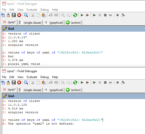

Are you using the same version of the debugger that matches your deployment? Earlier standalone instances of the debugger may predate some of the newest inspectors so will fail. Example below from the 11.0.2 debugger attempting to evaluate the yaml inspector that was added in 11.0.5, vs running in the 11.0.6 debugger that runs as expected.
Also note that some inspectors are client only so may fail in the standalone debugger/QNA mode and you need to switch it to local client mode
