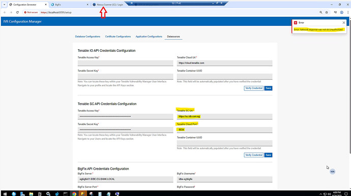

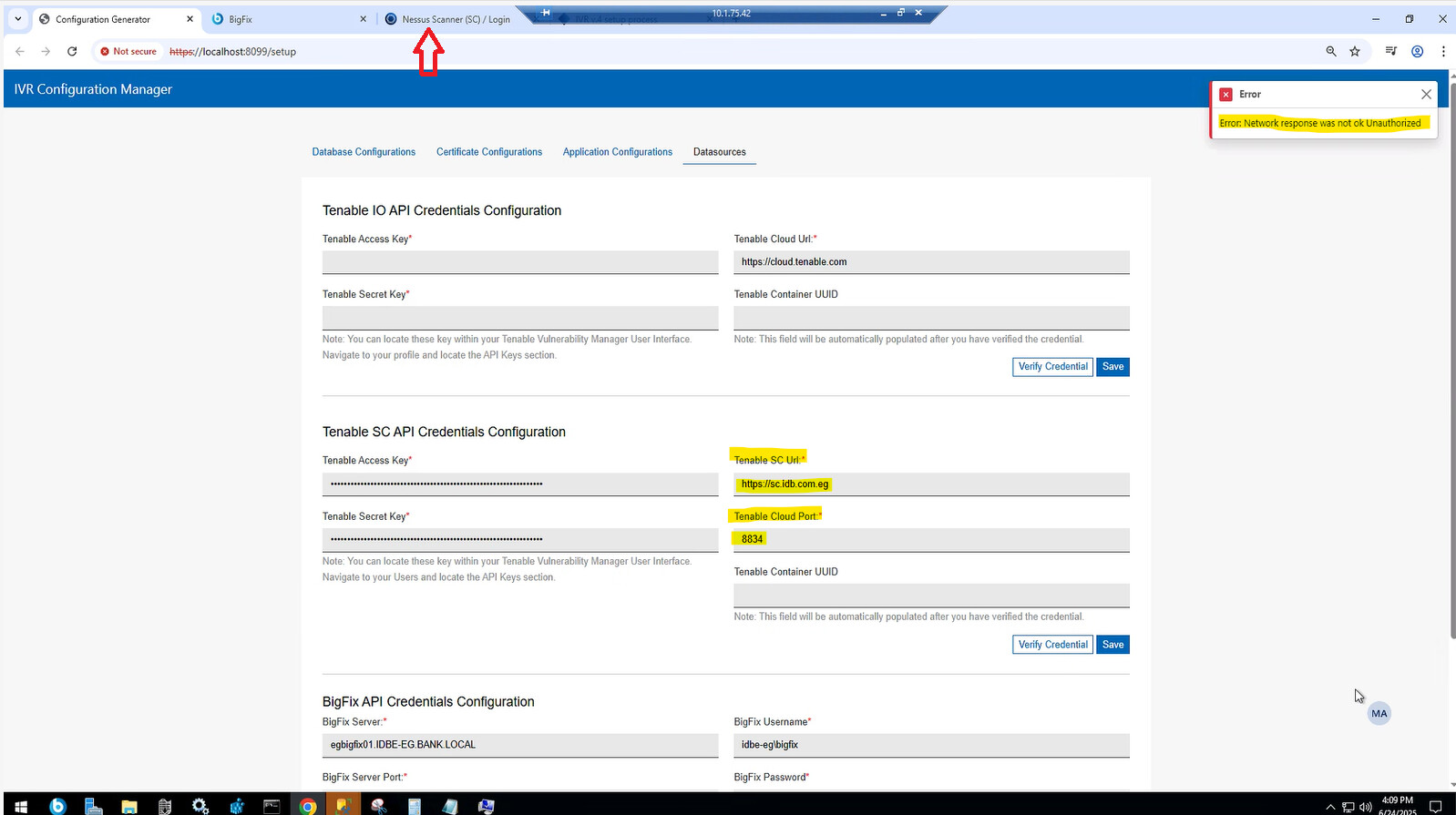

I am trying to integrate BigFix with Tenable SC using IVR4. I have successfully completed all steps until the Tenable SC API Credentials configuration. I obtained the Tenable Access and secret key and copied the Tenable SC URL, using both the IP address and name, but both attempts failed and gave me an error stating, “Network response was not OK. Unauthorized.”
I tried accessing both URLs (https://name:port and https://IP:port), and both opened successfully as a red arrow pointing.
Can you please advise on what might be wrong in this situation?
I already opened the URL and opened tenable login using username and password, not using Access and Secret Key (API credentials) , and if must login with API credentials how can I test it
I reviewed the link you sent; I found it related to IVR 2 and 3, not IVR 4. Also, for IVR4, it must be administrator, not auditor. so which one I should follow
