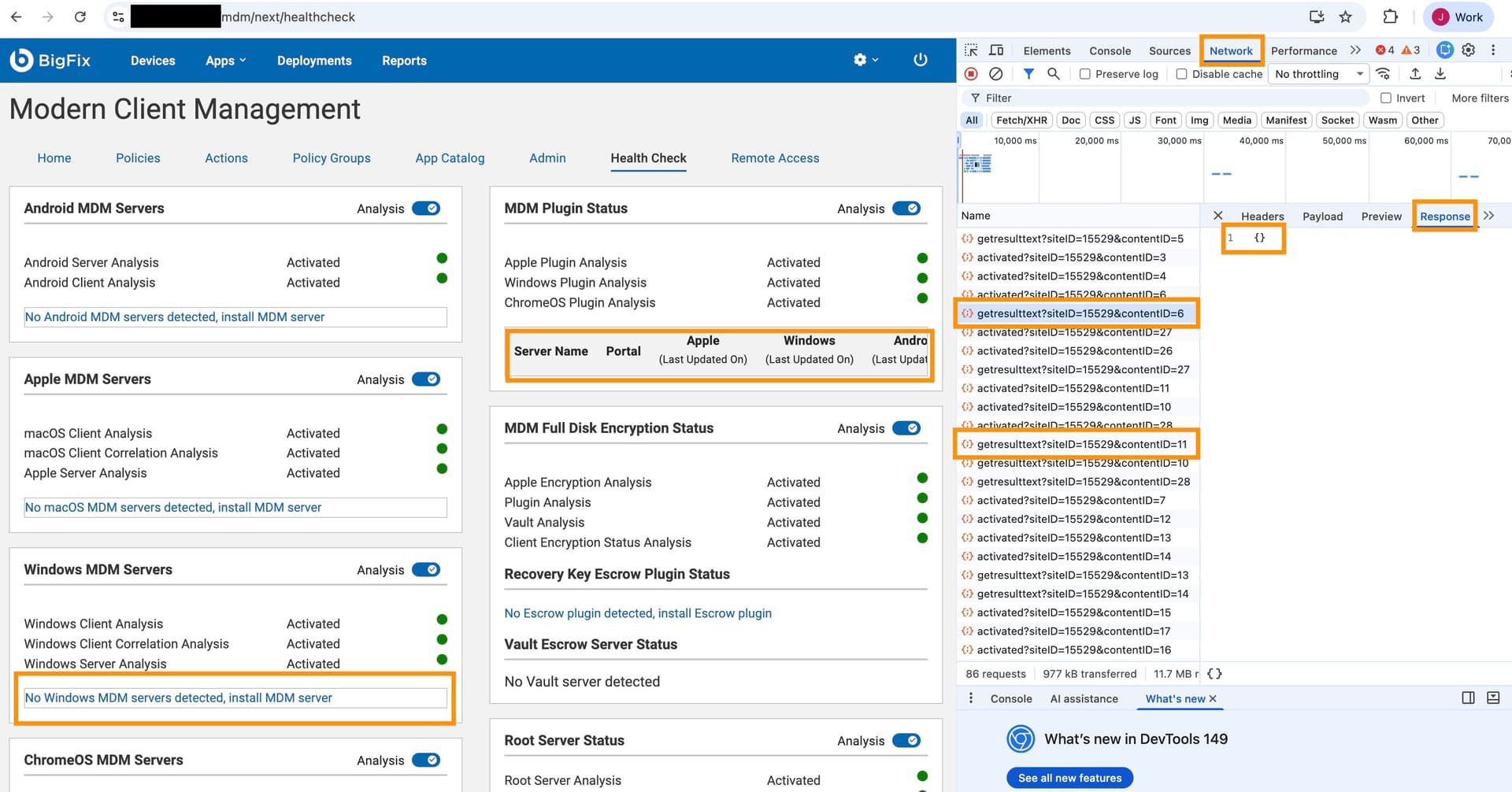

A good example of how you might notice the issue is in the MCM Health Check dashboard in WebUI. If data is missing in the dashboard that is present in analysis results in the console, that is a pretty good clue that you’re having this issue. In our case, information about the MCM server and Plug-in were present in analysis results, but not in the dashboard.

In case you’re curious what this issue looks like, see this screenshot of the MCM Health Check dashboard where the MDM Server and Plugin are missing. If we inspect the page and look for the analysis IDs for MCM Server and Plugin analyses (6 & 11), we see null results.
