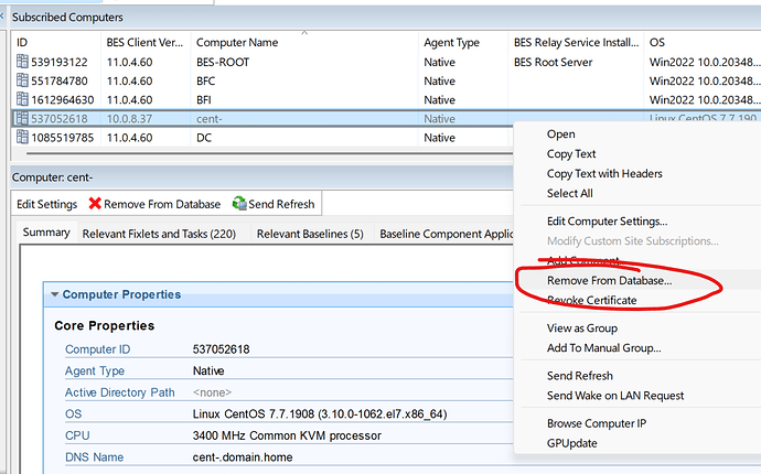

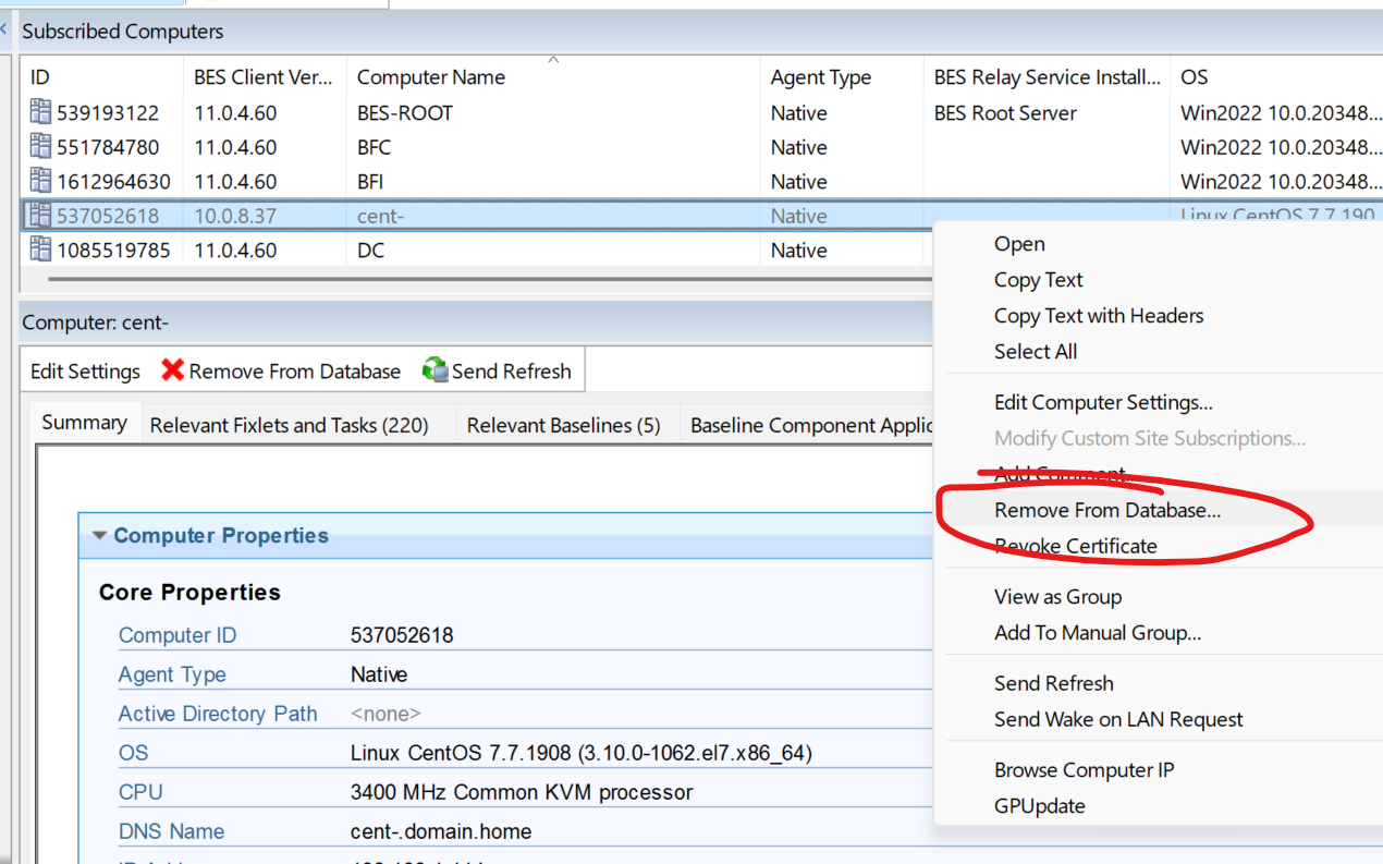

You should delete from the console, the duplicate computer for the instance that is no longer reporting, but it might take some time to be sure which one that is.
All the servers are reporting in the console with the new reporting dates, however our root server is not reporting after 29th and only duplicate 28th root server entry is active. Any suggestion. What if we restore the Bigfix**(BFEnterprise & BESReporting)**
It doesn't sound to me like a restore is necessary, and it would be likely to cause more duplicates.
Sounds like you've gotten past the Console Load issue.
For the duplicate computers, from the Console right-click each computer that is not reporting and select 'Remove from Database'
