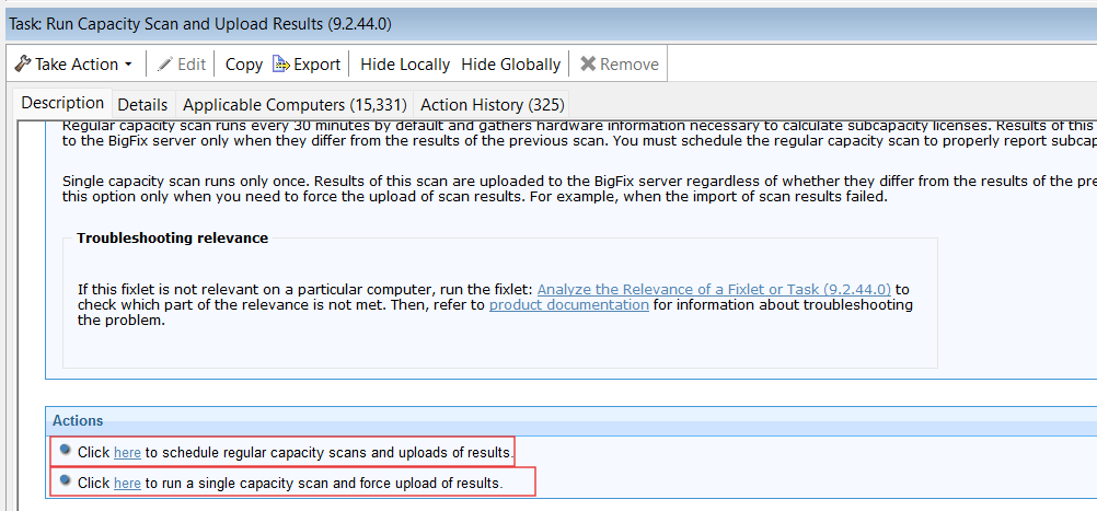

As per above example, ILMT has a fixlet called
Run Capacity Scan and Upload Results (9.2.44.0)
and it has 2 possible actions to choose from. When the action is submitted an running, is there a way to tell which of the above 2 action options were selected?
The easiest and simplest way is to check the action script which one is running. Compare from action1 and action2 of the fixlet/task. Let us know if this helps

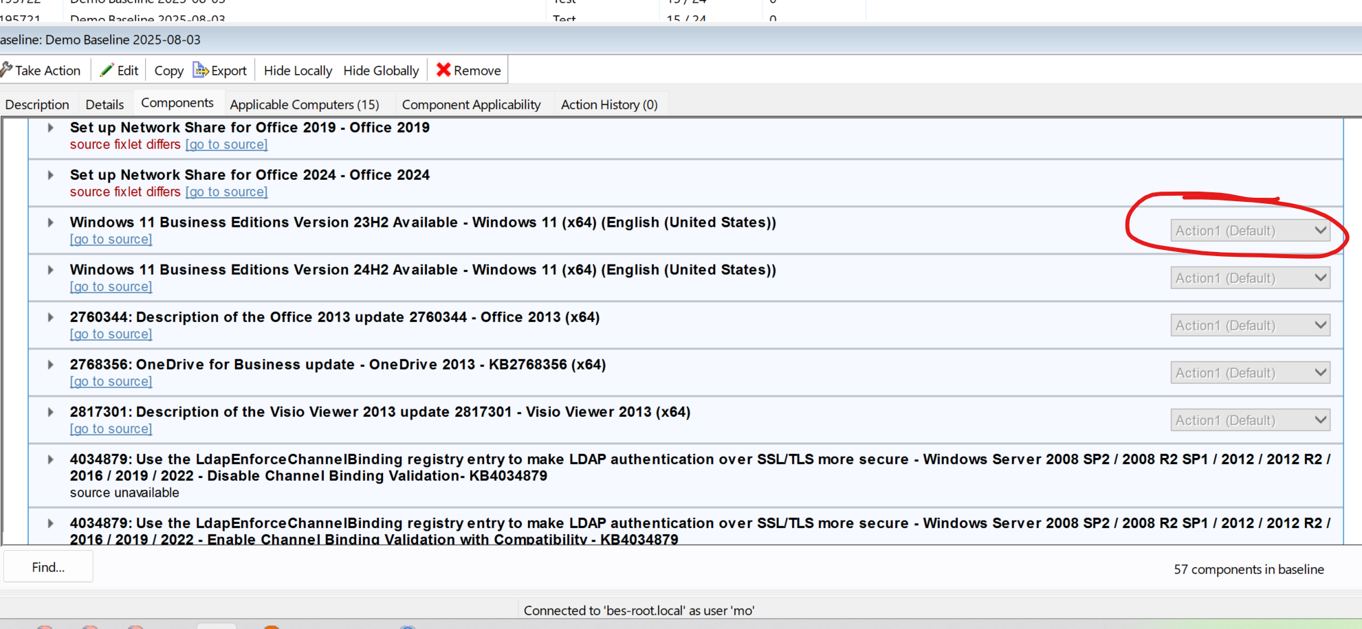

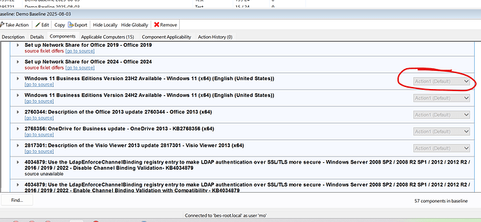

The Baseline itself will list which Action is selected for each component, that's the easiest place to look.
Action1 vs Action2 does not toggle from one computer to another, only one action is assigned in the Baseline Component.
