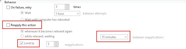

you can use reapply action option on --> execution tab,
reapply on which basis… kindly suggest.

This will run when the relevance become relevant again, but here I want to run this script twice in a week, and when the action executed successfully then this will not going to run on machines.
Here I believe I need to change the relevance, e.g. I need to create a log file and based on last modifying date of that log I need to create relevance, then I can use this option.

You need the Relevance to always evaluate as True.
Set the Action Constraints to run only on Monday and Friday.
Set the action to Reapply While Relevant, waiting 24 hours between reapplication.
I’d also recommend you ‘Stagger action start times over XX minutes’ so your machines don’t all scan at the same time.

Surely I will apply the suggested steps rather changing the relevance. Thanks You.
