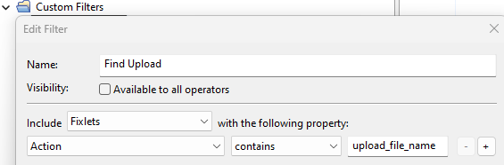

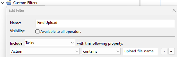

How to identify such actions:
  1. In the BigFix Console, use the Custom Filter to search for Fixlets or Tasks that contain the name of the uploaded file or related script content
Check both the Fixlet/Task and their related actions to see if any are still in progress.
