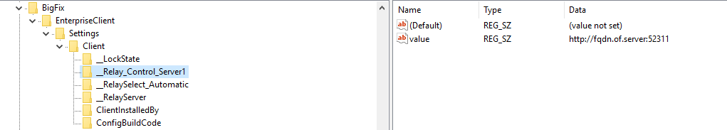

I have done a test using a clientsettings.cfg with the 9.5.8 client MSI and can happily report that all my clients settings from the cfg were present when the install ran, and I included some custom settings that are not integral the Bigfix client. The cfg I used was as follows and located in the same folder as the MSI.
ClientInstalledBy=Script
ConfigBuildCode=MyTest
__Relay_Control_Server1=http://fqdn.of.server:52311
__RelaySelect_Automatic=0
__LockState=true
__RelayServer=http://fqdn.of.server:52311/bfmirror/downloads/
I ran the MSI using msiexec passing the full path to the MSI
msiexec /i "C:\TEMP\BigFixClient\BigFixAgent.msi" /q
After the installation has completed, this was the contents of my registry, each value echoing what was in the cfg
This for me is certainly an easier option than editing the MSI. Of course I was using a static relay with a pseudo fqdn purely as testing but you could just as easily use automatic relay or any other settings that might be applicable for your deployment.
