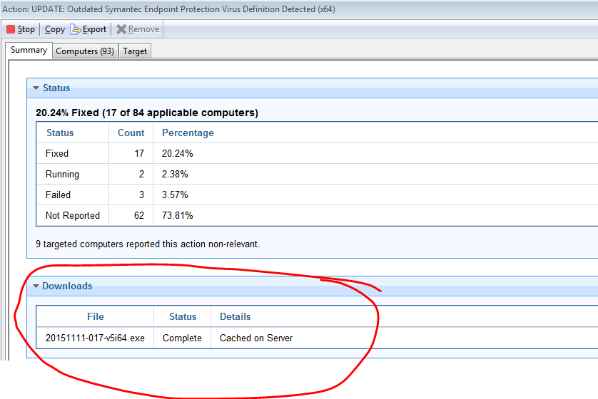

Well without much to go on, my first leap would be that your core server can’t retrieve the patches from the links within the fixlets. On your actions page, you should see a “Downloads” section that tells you whether or not your patches have been successfully cached. Ensure the downloads have completed there. If they display an error, troubleshoot that first.

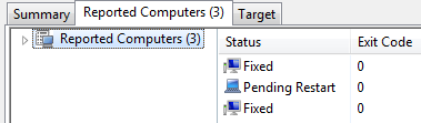

Note that beginning with 9.2.5, action exit codes can be displayed as a column in the Console:
Going to 9.2.5 and knowing that is now possible makes my heart happy :smile:
which property you have defined to get exit code becuase in my enviorment i have to click on every machine then i can see exit code .
You have to be on version 9.2.5 to see the Exit Code column.
