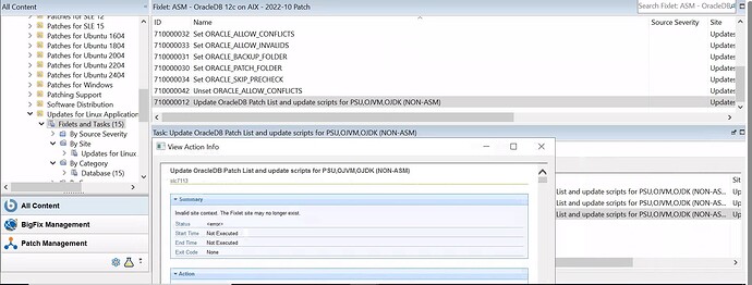

I have a downtime scheduled for one of the ORACLE DB server today at 19:30 PM IST. I have initiated the Update Oracle Patch List and update script (NON-ASM) but showing the below error:
FYI, this server is not applicable to this task and the customer want to remediate the Oracle Java SE CPUOCT2025 vulnerabilities for this server.
Your kind help will be valuable.

I think it will likely be difficult to diagnose this through the forum, especially given your short time to recover, and you should definitely get in touch with our Support team for some live troubleshooting.
Where I've seen that particular message before, involved a client that was being masthead-switched between two different BigFix deployments, resulting in it unsubscribing and resubscribing to the fixlet sites. I'd check that your client is still subscribed to the site and check for any other issues in the BES Client logs, and get that Support case started.

Thanks for your response. But i just want to confirm if BigFix supports Oracle DB JAVA SE patches for Linux? As i checked in the Linux Middleware site, none of the servers that are shared by the client are applicable to this Update Task.
