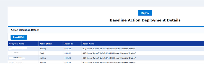

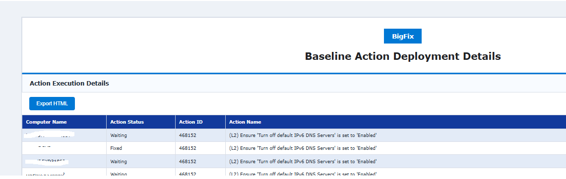

You can use the attached custom report based on your requirement.
It does have export HTML function, you can also schedule it as HTML report.
BaselineActionStatus.pdf (57.1 KB)
Report layout:
