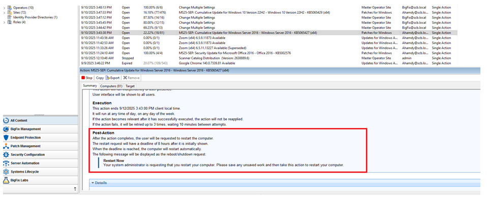

We are facing an issue with BigFix where some targeted servers are restarting immediately after installing updates and other servers not, even though the restart has already been scheduled for 8 hours later within Post Action. Unfortunately, this behavior is causing unexpected downtime during working hours.

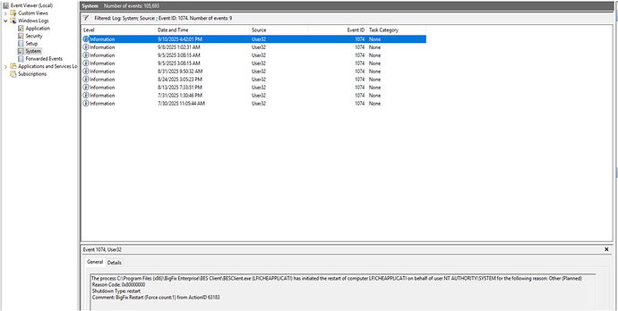

Here are the logs and screenshots related to this incident:

At 17:16:38 +0300 -
BigFix Restart (Force count:1) from ActionID 63183

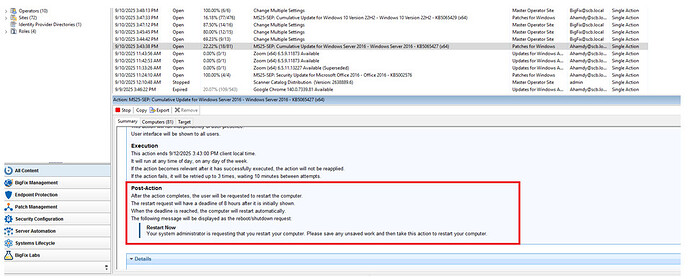

From the screenshot in your first post I’m not exactly sure what is your expected behavior.
Based on the settings in the screenshot, what will happen is
  • When the action is finished running it will reboot the system. NOTE that if nobody is logged on, the reboot will happen immediately after the action completes. That’s a common source of confusion.
  • If someone is logged on, a message is displayed requesting the reboot and giving them the option to shut down now or to delay the message. After 8 hours they will not be able to delay the message any further and the system restarts.
There is no setting that will “reboot the system 8 hours after the action completes”. If you need to reboot at a specific time, you’ll need to use a second action for that restart and configure the action-start-time parameter accordingly.
