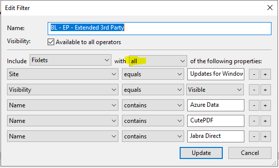

We only want to patch a small portion of the Extended 3rd party patches. We don’t use policies, mostly because we are multi-tenant. I do use filters, extensively, to get fixlets to update specific baselines. Example:
The challenge is, Filters do not work for what we need because we can’t do an AND/OR.

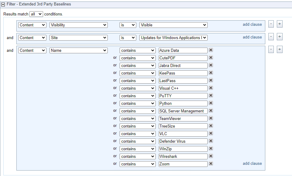

The problem with the Web Reports, there is not a way to select all, Add to existing Baseline.

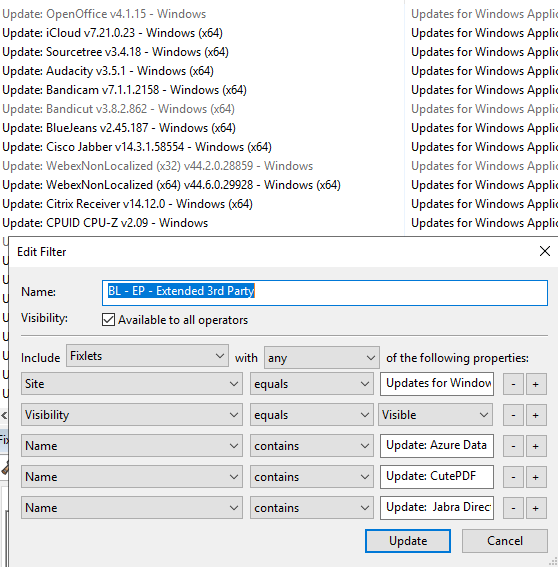

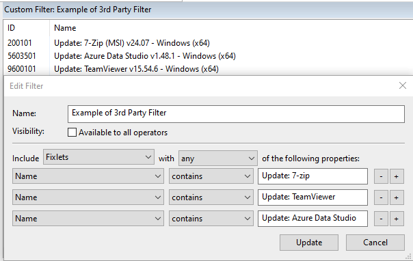

@D.Dean, all of the “Updates for Windows Application Extended” content begins with “Update:”. Could you possibly use this approach instead as depicted in this example?

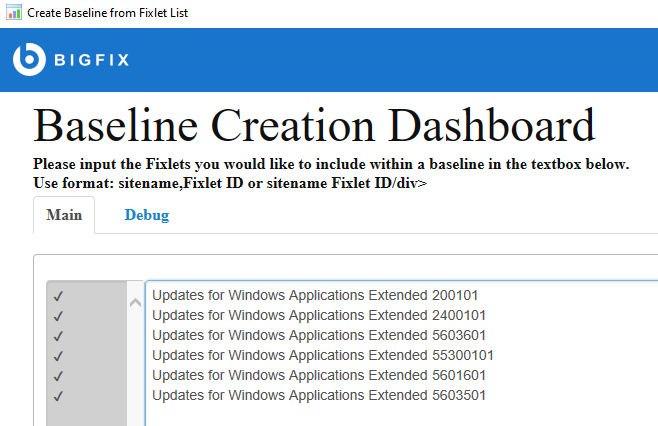

@D.Dean, if you have access to “BigFix Insights for Vulnerability Remediation” and the “Create Baseline from Fixlet List”, this may also help accomplish or assist with your end goal of creating a baseline from a list of fixlets:
Enter the list of sitenames and fixlet # as depicted below.

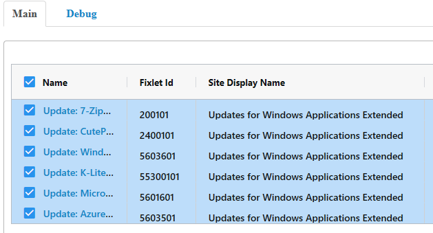

Then click on the “Validate Input” button to proceed.
Then select the fixlets from the list and click on the “Generate Content” button to create your baseline.
