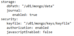

Hello all,
I need to check compliance for DISA STIGs by pulling content from MongoDB files (mongod.conf) that could have some inconsistencies in terms of how the lines are laid out. Here’s a default example, and notice the lack of a blank space before the “security” stanza. There also could be anywhere from 1 to 5 or so setting lines below each stanza header (like 4 under “tls” for example)
tls:
   mode: requireTLS
   certificateKeyFile: "/u01/mongo/etc/ssl/hostname.va.gov.pem"
   CAFile: "/u01/mongo/etc/ssl/vapkirootssub1.pem"
   FIPSMode: true
storage:
   dbPath: "/u01/mongo/data"
   journal:
      enabled: true
security:
   keyfile: "/u01/mongo/keys/keyfile"
   authorization: enabled
   javascriptEnabled: false
For the most part there is one line underneath each stanza I need to return a boolean on. For example, I need to confirm if the “enabled: true” line underneath the storage stanza is present:
If (next line of it as lowercase contains “enabled: true” OR next line of next line of it as lowercase contains “enabled: true” OR next line of next line of next line of it as lowercase contains “enabled: true”) of line containing “storage:” of file “/etc/mongod.conf” then “Compliant” else “Not Compliant”
Using a series of "Next Line of it … " works fine (as long as I include enough of them), but it’s hardly elegant.
Because of the possible inconsistencies as noted above, I don’t see another solution. I was thinking of a RegEx but I"m not that familiar with those and unsure if we could get it working anyway … because of the possible inconsistencies.
Any ideas?
Thanks!
