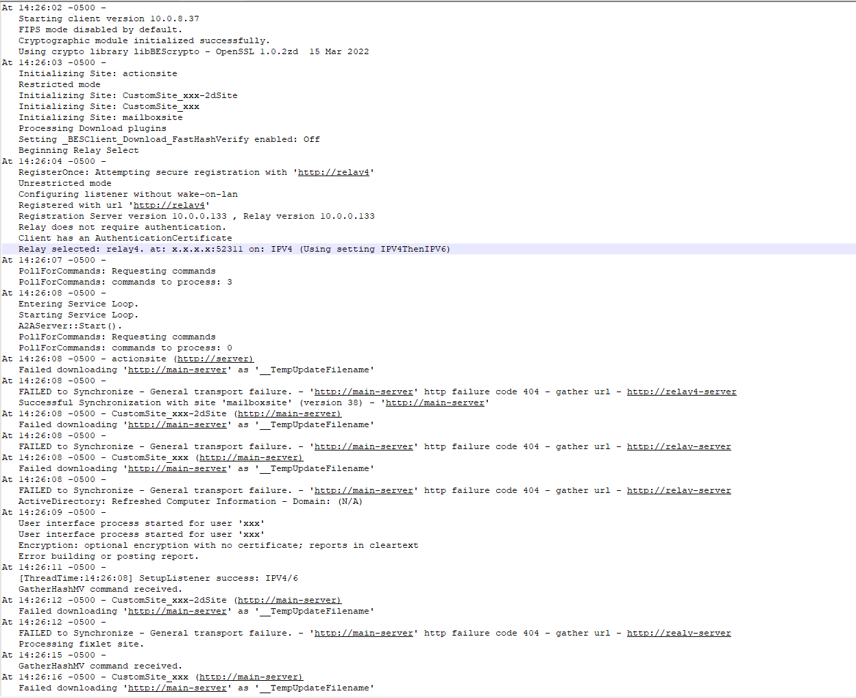

I have a particular endpoint whose logs have been giving this error message “FAILED to Synchronize - General transport failure. - 'http://xxxxxxx' http failure code 404 - gather url https://relay4. xxx””

Http error 404 - can mean lot of things - the actual line can help.
For example - What does the error 'http failure code 404' from the Client log for an opsite mean? - Customer Support
I can share you a can where clients reported 404 on some op sites - after restarting the Relay and it's Parent Relay the errors which showed on the Relay Diagnostics on the Relay resolved and everything was resolved

@olu_bandzz Are you certain your agent is using port 52311? The URL in your original post appears to show the agent trying to use port 52411 and the URL failing is to custom site.
Side note, you may want to edit your post to remove any sensitive and host specific information :wink:
@SLB Thank you for the advice. Yes, we use 52411 instead of the default 52311 port.
