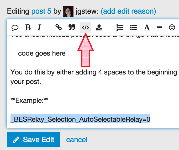

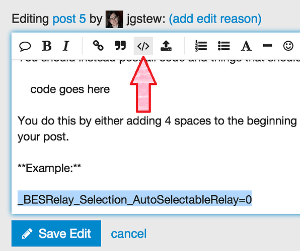

You need to put code and client settings in a code block using the “</>” button in the UI so that it does not get messed up.

The forum software on this site interprets “_” on both sides of a set of text as an indication to italicize.
You should instead post all code and things that should be formatted very specifically in a code block like this:
code goes here
You do this by either adding 4 spaces to the beginning of it, or by clicking the “</>” button in the UI when writing your post.
Example:
_BESRelay_Selection_AutoSelectableRelay=0
