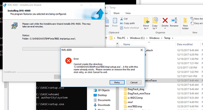

That pops up an interface! So basically when the installer starts and runs as system, there are no folders called mia* in C:\Windows\TEMP, then it creates a folder and immediately complains that the folder exists. If I try to delete/rename that folder, Windows complains that it’s open in another program. The install never completes.
For fun, I ran the installer interactively as a regular admin and watched C:\Windows\Temp. Either the mia* folder is not created at all, or it’s created and deleted so quickly during the successful install that I didn’t notice it happen.

Getting the UI and error message is a huge hint to where the problem is.
You might be able to get around this issue by specifying a temp folder on the command line. Another option might be to temporarily override the %TEMP% env var for the command only. I know there is a way to do this for Linux.
It seems like it is trying to copy the file to the same location that it is already located in.
My guess is that folder gets created under the user account’s temp folder, not the Windows/Temp one.

I’ve been playing around with setting anything that looks like it might affect temp folder (TEMPDIR and SUPPORTDIR) in the command install but so far no luck.(InstallAware for Windows Installer - Pre-Defined Variables)
I also tried setting %temp% to something other than C:\Windows\Temp in the session but it still tries to use that directory

Another thing might be that it isn’t using %TEMP% but is using something similar as the reference.
I think the issue is that the user temp path for SYSTEM is the same path that it is using, which is why it ends up trying to copy a file onto itself.
