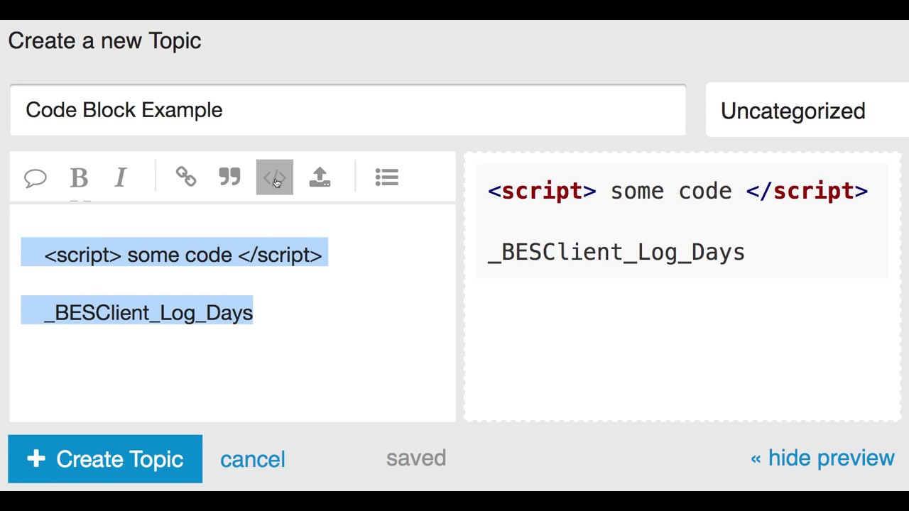

Here is a video showing how to put text into Code Blocks on the forum to prevent it from messing up the formatting:
Sir, you must Pin This!
