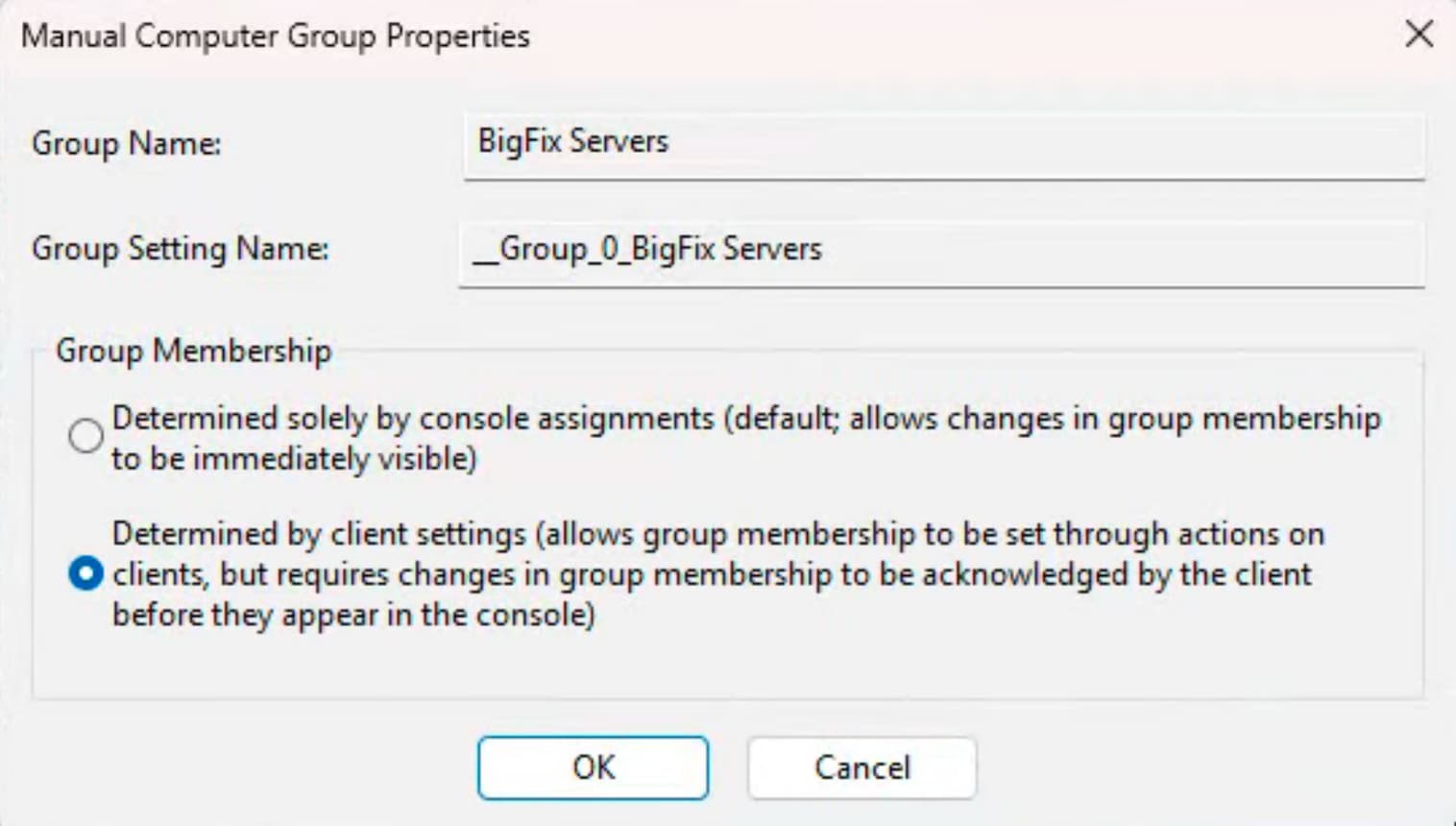

I'd like to enroll a new device and have it sorted into a manual group based on clientsettings.cfg at time of installation. I'm not sure, but one complication might be that there are spaces in the manual group's name.
The group is set to determine group membership by client settings

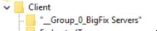

Because there's a space in the name, I also tried
"__Group_0_BigFix Servers"=True
but this just added the group with quotes around it:

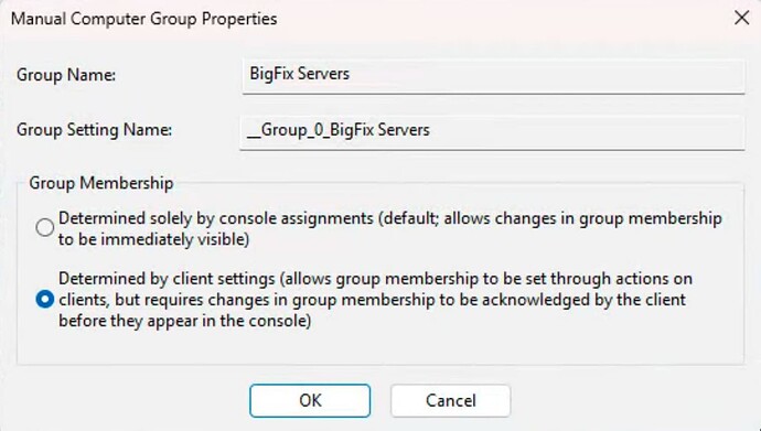

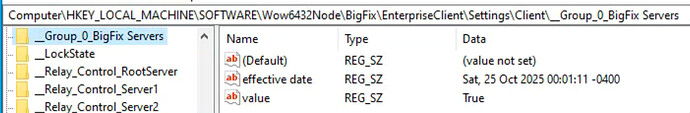

This group used to be "Determined solely by console assignments", but I changed it to "Determined by client settings" to facilitate this workflow. On computers that were added to this group previously, I see the key in the registry set successfully with a space in the name:

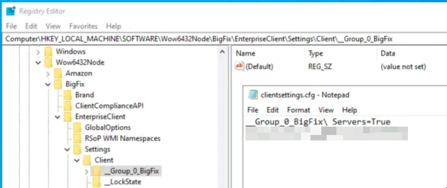

Trying a backslash doesn't help much either:

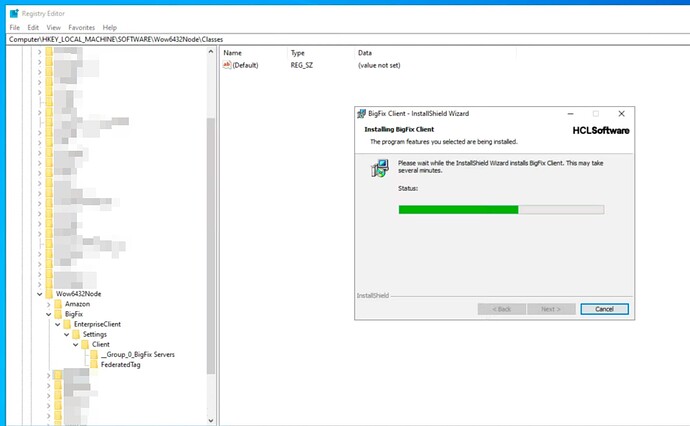

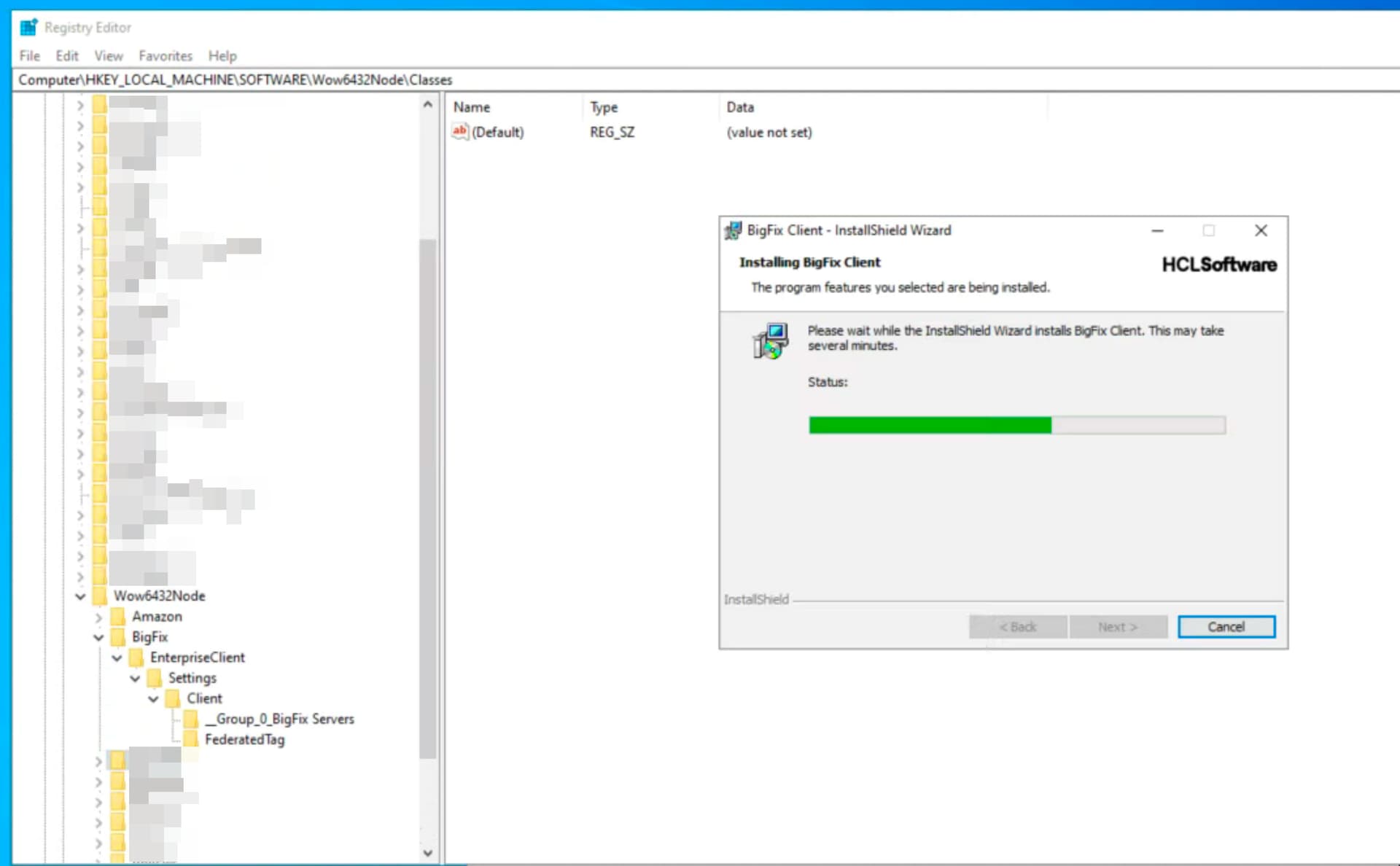

Here's something strange:
The group does seem to get added during installation, when it's listed in clientsettings.cfg normally (no quotes, backslashes, etc):

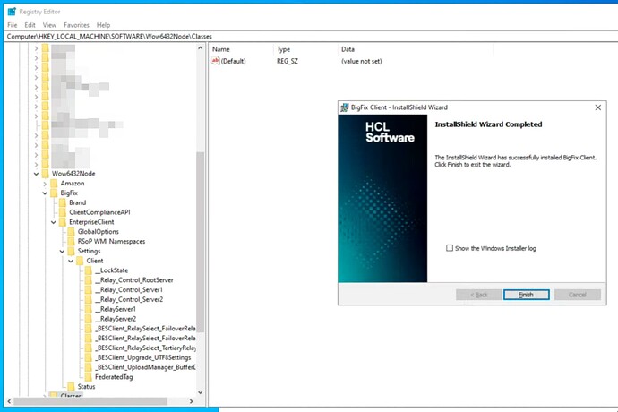

But when the installation completes, the group gets removed:
I would recommend using a specific client setting during installation, for example: New_Build_BFXServer=True. This ensures the setting is preserved and supported by the client. The likely reason your client is deleting it is that there is no active action from the console side for group creation, typically a background action is triggered whenever a group is created.
Additionally, it is recommended to use a server group (it reduce re-evaluation) if an RP already exists. Otherwise, proceed with an automatic computer group, as it is easier to maintain and does not require ongoing manual upkeep the way a manual group does.
I would agree with @vk.khurava and was going to ask @eg2428 Is there a reason that you wanted it as a Manual group specifically?
We have some devices that we do something similar things with in order to tag them as that use case.
In the clientsettings.cfg file we have an entry called __DeploymentType=Monitoring so that it creates client setting when the Bigfix client installs. Then we have an automatic computer group that allows us to populate it and use it for targeting for other tasks/policy actions.
exists settings whose (name of it equals "__DeploymentType" and Value of it equals "Monitoring") of client as string
You can review the product documentation regarding computer groups as well. But Manual groups are intended to be a static list and isn't created by the agent through client relevance which is why your manual groups aren't populated automatically.
