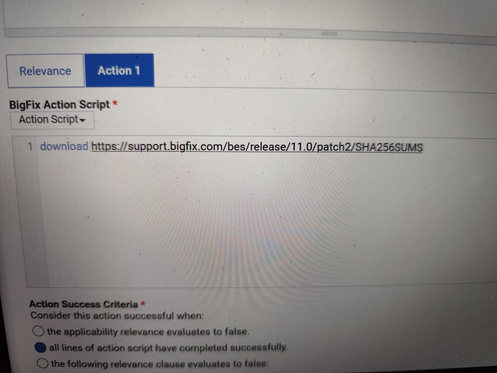

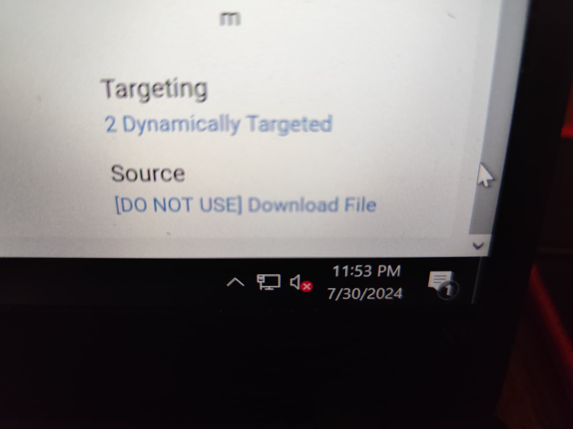

I have a very simple task that downloads a file using the download command, it works when targeting an specific list of clients but it fails when I use a dynamically target action.
the action is as simple as follows:
download http://hostname:port/dir1/dir2/file.txt

It is a Task, there is not really relevance. It is set as True as this is a task I need to run on every endpoint, the success criteria is set to be true when all lines executes successfully, and as I mentioned before it only fails when I deploy it with dynamic target.
That is interesting. I am doing exactly the same and it is failing.
