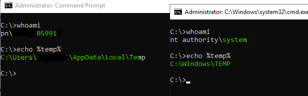

Where did you look for the temp folder?
BigFix runs as the system. It's temp location is usually c:\windows\temp.
That is where you should look for the log.
Hi Dean, you were right, it was in C:\windows\temp, here is what the log generated:
