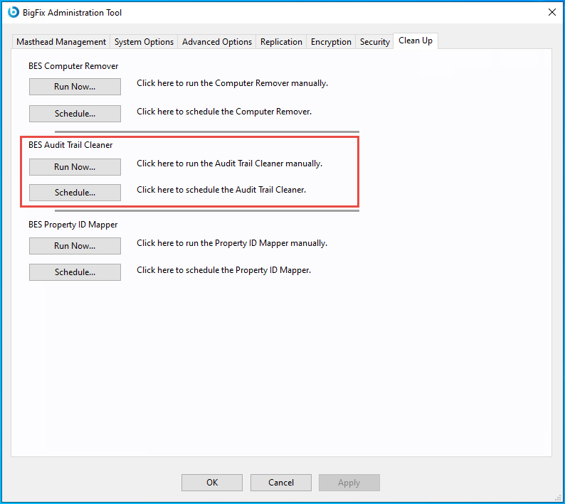

Deleting actions will change the value of the “IsDeleted” field in the DB table from 0 to 1, however, the data will still exist until you run the audit trail cleaner feature in the BESAdmin.exe. It is a good idea to run this periodically to prevent the DB tables growing to where things then take longer to run, such as daily table defrag. If your company has a data retention plan, I would think about creating a weekly schedule to clean up deleted content that is over x days old.
This span more than just actions but you can choose what content to clean up.

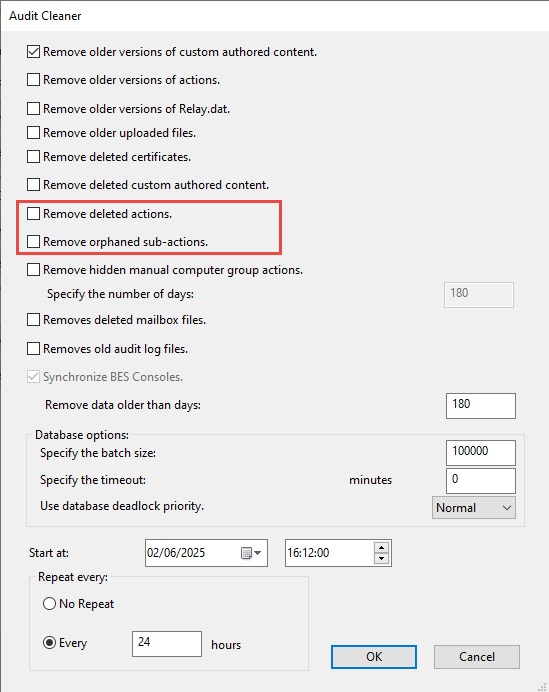

This depends on how your BES Administration Tool is configured, specifically the BES Audit Trail Cleaner settings. When an action is deleted from the BigFix Console, its data (including results and metadata) remains in the database until the Audit Trail Cleaner is run and removes it, based on the defined retention period.
If the Audit Trail Cleaner has not run yet, historical data remains queryable in the database for audit purposes. However, once the cleaner purges that data, it is permanently removed and cannot be retrieved from the database.
You can adjust the retention period in the Audit Trail Cleaner settings to retain historical data for a longer duration. However, increasing this period will result in a larger database size, which may impact performance. It’s advisable to balance your organization’s audit requirements with potential performance implications. For optimal retention settings and performance considerations, consult HCL Support or refer to the official documentation.
