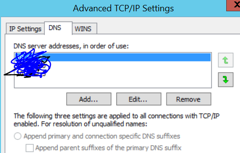

We have 200+ servers are we need servers DNS IP and please advise for this automation task or flexlet is there ??

I’m not suly about , I’m have only option change dns goto network adaptor change dns ips
You’d use netsh.exe to change the DNS servers. I’ve done this in fixlets before but it will take a while to dig up the reference again…hopefully the hint to look at netsh.exe options can be helpful.
