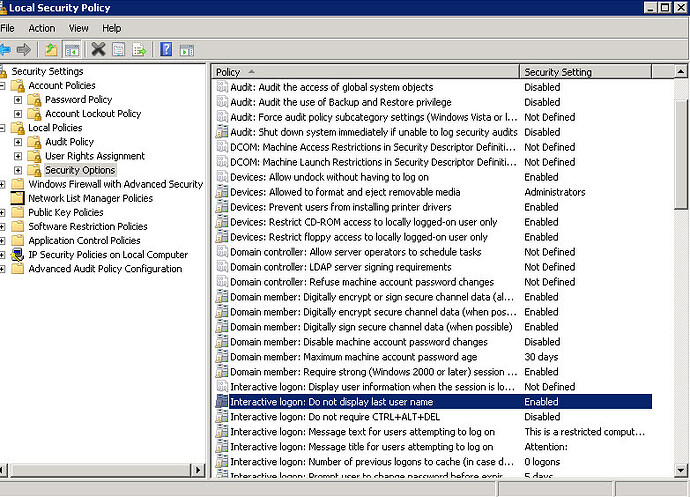

I am wondering if someone has written relevance to dig into the Local Security Policy. The out of the box fixlet I am looking at is Interactive Logon: Do Not Display Last User Name, this fixlet looks into the registry and we do not set this in the registry we set it locally.
Any thoughts.
See attached screenshot

Thanks for the info, I’ll give this a shot and check the results. I think the problem is this maybe set on some servers and not on the other. When our Security department checks the results they go to the local security policy to validate.
