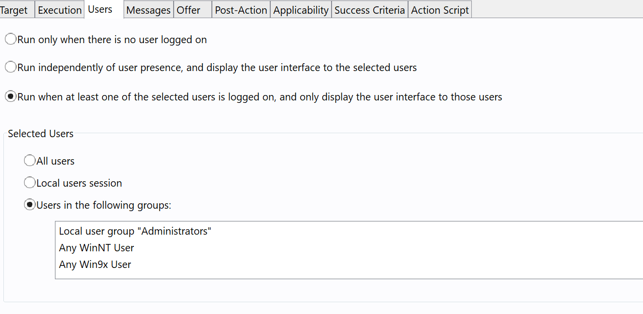

Is there an alternate way to use a ps1 file?
If Client version is 10 or greater than 10 you can directly use native powershell script from script type -
I was just looking at that.
But how would I go about with the run as current user?
Thanks!
This can be achieved from users tab
I think there will be some constraints here .A User Must Be Logged In: If no user is interactively logged onto the target machine, the action will fail or remain in a "Pending Login" status. The script will only have the permissions of that specific logged-in user. If the user is a standard non-admin account, the PowerShell script cannot perform administrative tasks (like installing system-wide software).
All my standard users are blocked from running powershell meaning I would need to allow powershell for standard users before running…correct?
Yes, permissions should be allowed for users to execute the script
If your PowerShell script requires administrator privileges, it cannot be run as the current user unless that user is already a local administrator or explicitly provides elevation (UAC). In that case, you should deploy it using GPO or another mechanism that runs it with administrative privileges. If the script only performs actions that a standard user can execute, then running it as the current user is fine.
User Tab just manages when the action can be run. But all actions run by default in the context of the client (System on Win, or root on unix like) unless you use the override option.
Users tab
Contains the settings to run the action based on which and if specific users are logged on the computer.
