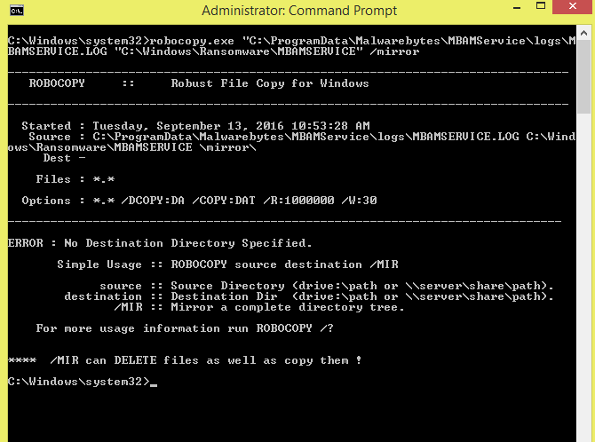

same result - is it possible to add a log file to the script to check why its happening
if i run the robocopy command in command prompt this is the result
Two issues – as I said before you cannot use robocopy to sync a file you must sync a directory. We also appear to have lost a quote at some point.
