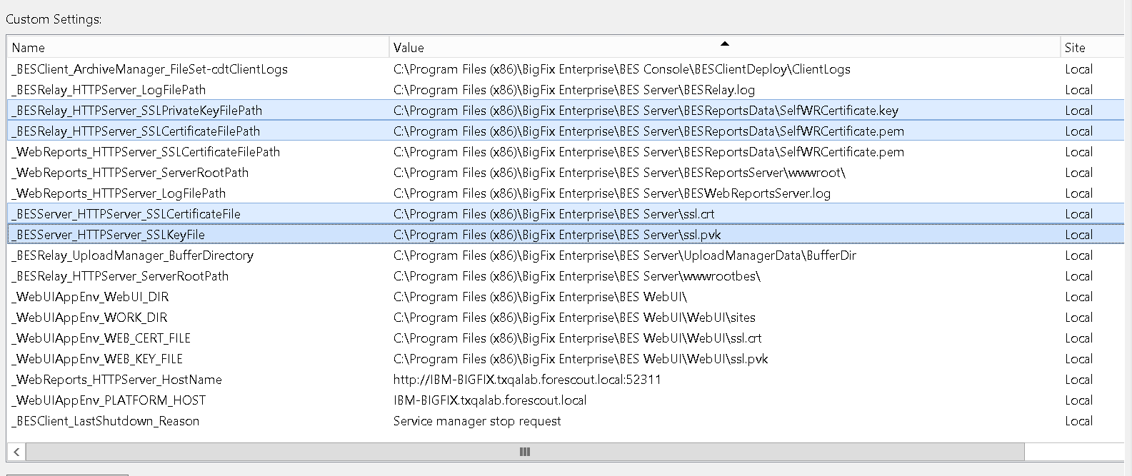

In the screenshot below,
ssl.pvk and ssl.crt are the private key and cert file created for BigFix server using it’s IP address and Hostname, since the original certificate presented by BigFix server doesn’t provide the SAN causing the application sending REST API requests to the server to fail when server validation is enabled.
Question: Should I also Change the _BESRelay_HTTPServer_SSLPrivateKeyFilePath and _BESRelay_HTTPServer_SSLCertificateFilePath to point to the custom certificate? It is currently left at the default certificate. My understanding was _BESServer is for application connecting to BigFix using REST API, while BESRelay is for Hosts managed by BigFix to connect to the root server.

Thanks @DanieleColi !
That helped to pass Certificate validation by pointing _BESRelay_HTTPServer_SSLPrivateKeyFilePath and _BESRelay_HTTPServer_SSLCertificateFilePath to the custom self signed certificates. While it worked for some APIs, it broke the rest

Could it be because the BESRelay certificate and key filename settings are not pointing anymore to those in BESReportsData (SelfWRCertificate.pem and key) and the 2nd API Request needs to connect to BES Web Reports Server? My self signed certs replaced those. Again I am on Version 9.5. Thanks!
Search for that message on the Customer Support Knowledgbase..
That was correct. Since you changed the SSL certificate, Web Reports could have problem talking to the Root Server: add it as a new datasource (and remove the old one).
