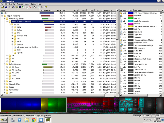

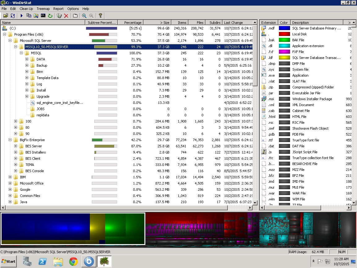

As per suggestion of @strawgate I’ve installed Windirstat and figure out the space is consuming by both MS SQL and Bigfix server as well. @jgstew yes the root server and the SQL db both on same machine. and my total volume size is 150 GB. Below is the screenshot of Windirstat result.
Only about 70GB is being used by BigFix which is well within the size I would expect an environment to be.
You could move the SQL backups to another share but…
The cost for you trying to reduce it further is probably higher than the cost of just expanding the storage (Or adding a disk and moving it to that storage).
Your DB is bigger than I would have expected, but I agree with @strawgate , I would recommend throwing storage at the problem if you can.
