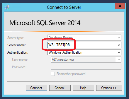

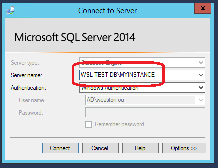

Are you using Default or Named Instances? SQLSERVER or SQLSERVER\INSTANCE

When you connect with SQL Management Studio does it look like this:
Or like this:
Hi Strawgate
while connecting to the SQL server i am putting my server hostname and then user name and password to connect it and it successfully connects.
