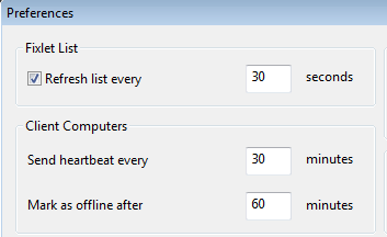

hi ,
please check “mark as offline after” value.

Thanks for your response. I have the Refresh set to 300 seconds, Heartbeat 15 mins, and Mark as Offline at 45 mins. Are these goodd values?
