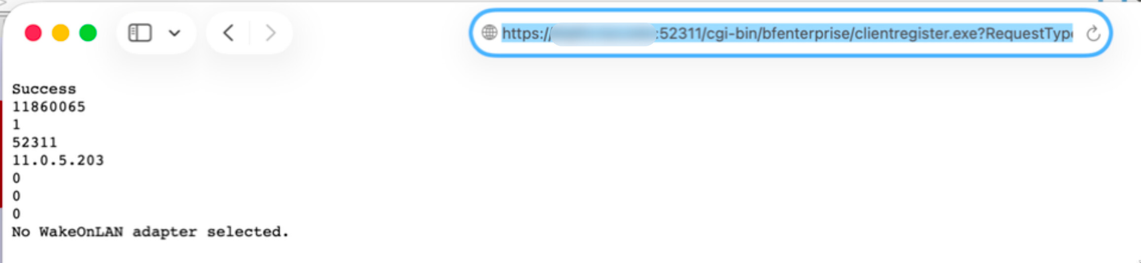

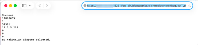

On one example device, I can successfully reach out to the root server using the registration URL, e.g.
so there should be no reason network-wise why the client doesn't reach out, it just never does.
