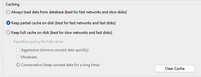

I’d like to change BES Console cache setting to “Keep partial cache on disk”. The default is “Keep full cache on disk - Moderate”. I’d also like to know that is there a way to change the default cache setting?

On a given terminal server, I'd like to nail down the cache setting to, say, Partial.
OK, that one would be via the registry after all. I believe you'd set the following under
[HKEY_CURRENT_USER\Software\BigFix\Enterprise Console\Preferences]
"WriteCheckpointOnExit"=dword:00000001
"UseSQLiteCaching"=dword:00000000

Ah, yes, my mistake. Ignore SQLCachingPolicy for this configuration (removed in my post above).
