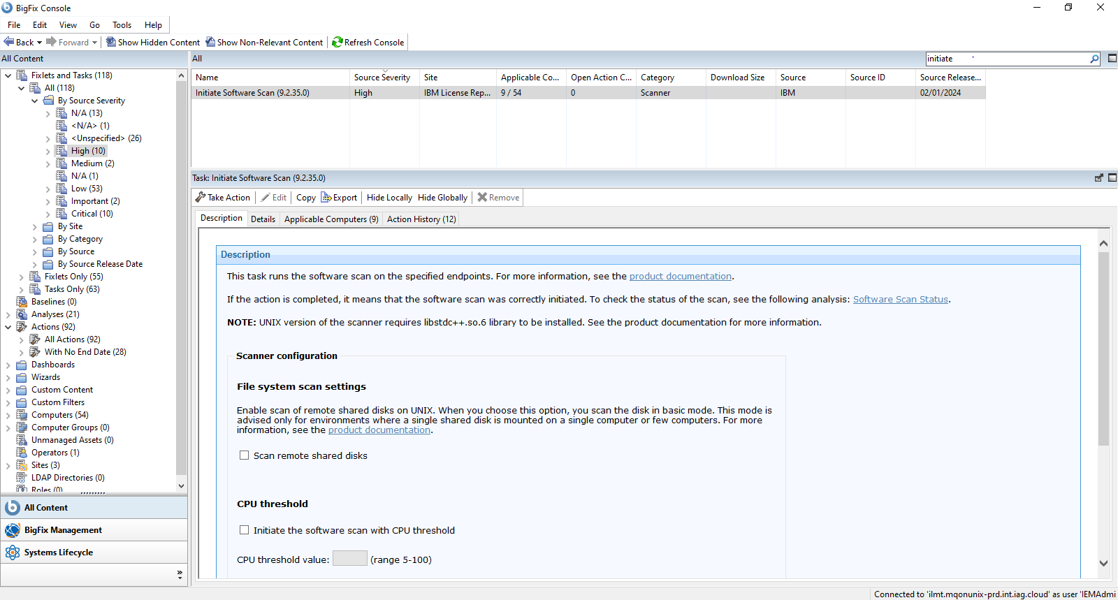

Thank you very much for the reply Jason. It was really a big help. I have upgraded console installed on my Windows desktop. I could login. I have another issue now. I need to run few routine scans like “Initiate Software Scan”, “Upload Software Scan Results (9.2.35.0)”, “Run Capacity Scan and Upload Results (9.2.35.0)” but in each of this action I could see Applicable computers count is less than the total computers. Pls refer the screenshot as attached.
I want to run the scan against all 54 computers perhaps it does not act on them at all. I tried clearing console cache also. Pls guide.

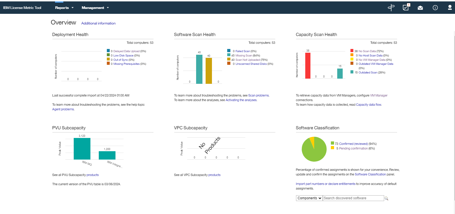

In addition to previous email, basically I am looking for clearing discrepancy on my ILMT home page (Dashboard)
I am trying to make following values zero but somehow I ma not able to.
45 Missing Scan (84%)
40 Scan Not Uploaded (75%)
38 No Scan Data (72%)
I am new to BigFix and ILMT and learning with the experience or issues coming across. Pls advice.

The numbers you are seeing to initiate software scan are related to where your ILMT Scanner is installed, and the overall applicable count of 54 that you are seeing is related to your ILMT site subscription.
Verify whether the ILMT scanner is installed on every device that is eligible for the ILMT site.
You should investigate fixlet relevance and validate them for the failing machines if they are still not applicable.
And related to your dashboard numbers, they will eventually grow when you have sufficient data based on scan+import.

Thanks for the reply. Even if I try to run the action “Install and upgrade scanner” on selected all 54 computers’ it just runs for 2 computers. I do not understand why does any of the action run on all the selected computers?
Each Task or Fixlet will only run on the computers that are “Relevant” for the task, based on the detection logic that can be found on the Relevance tab.
This allows, for instance, setting up a Policy Action that is set to never expire and to reapply whenever it becomes relevant again, for the Scanner Installation. If you target “All Computers” dynamically, then any new computers you add later will install the scanner, and any computers where a user removes the scanner will become Relevant again and re-run the action.
Relevance also helps with sequencing and I think is leading to some of your confusion. A computer only becomes Relevant to the “Upload Scan Results” task after it runs a Scan; and it only becomes relevant to the “Initiate Scan” task after the scanner is installed.
I realize you’re probably an ILMT-only customer, but in the case of Patching, we could create a single patch Baseline that applies to all Windows computers; when we action the baseline, each computer would only execute those Fixlets/patches that are Relevant to it (a Windows 10 client would skip all the patches for Windows Server; a Server would skip all the Office patches if it doesn’t have Office installed; etc.)

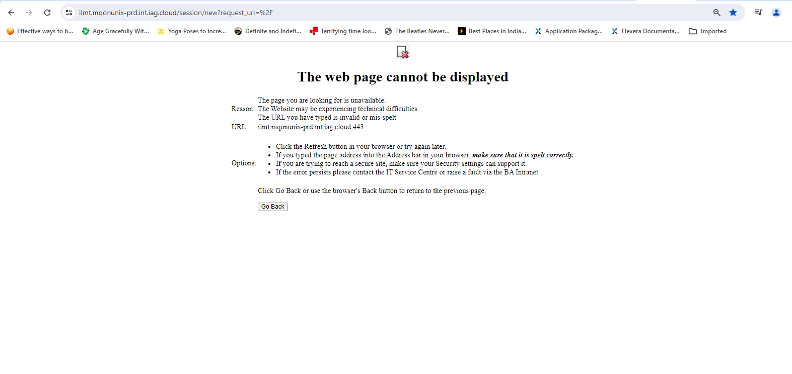

After upgrading the ILMT I was upgrading different components to matching 10.0.10 version and suddenly when the tasks were running my ILMT web URL and BigFix console stopped working. Even after rebooting the server issue is not getting fixed. All the services are up and running fine. I could see the following errors repeatedly :

BigFix_Console_Error
Pls guide how could I fix this issue.

You’ll probably need to open a support ticket then. Without a clear idea of what you have going on it’s difficult to say. I.e. have you turned on the Red Hat Firewall, have you broken your routing, is your name resolution working, … there’s a lot that can block a connection between your Console and the Root Server.
Your first log snippet indicated the services had been shut down, but if you’re sure they’re running now then you need to determine what’s happening network-wise between your Console and the Root Server.
Oh - wait a minute - I can see now in your Console screenshot “Couldn’t resolve hsot name” - either you typed in the name wrong, or your DNS or name resolution is down.
Is the ILMT application running? If it’s installed on the Linux server, check if it’s running or restart the application. Then check the application tema.log for any errors.
