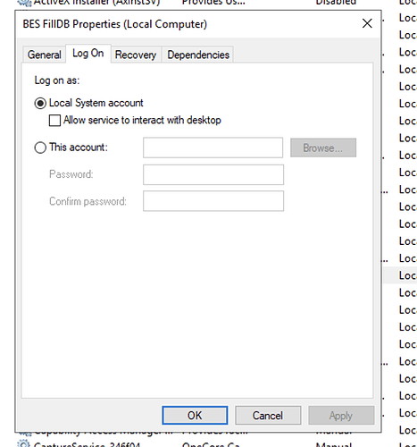

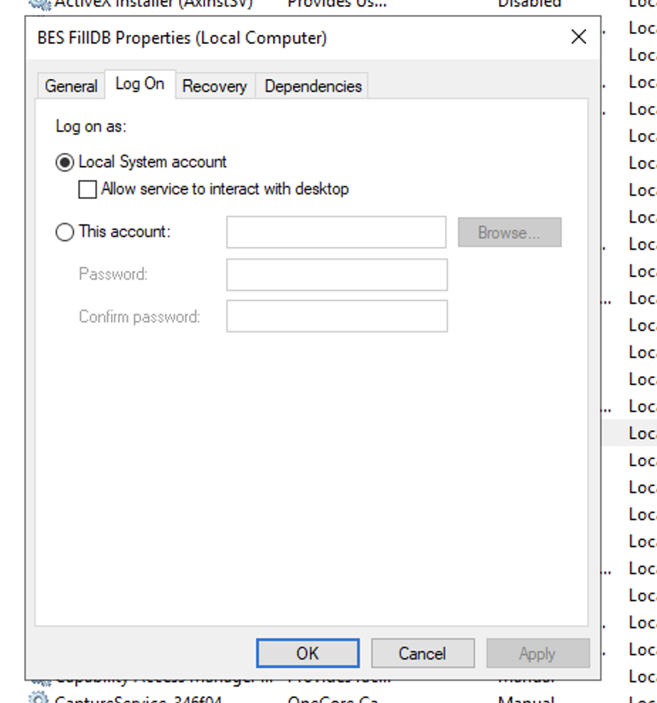

I have completed step 1 and 2, but step 3 i’m not sure of.
On the Master Server, change the LogOn settings for the FillDB, BES Root, and Web Reports services to the domain user or member of the user group created in step 2, and restart the services.
So this logOn in the services correct?
If not, where would it be?
Just wants to make sure there isn’t another place I need to change the logOn credentials.
Yes, that’s correct. You need to provide your service account, which has access to both the infrastructure and configure the FillDB services on both the Master and DSA servers. Ensure that the service account is configured with the necessary permissions.
@vk.khurava thank you for clearing that. One more thing, in the document only stated that this needed for master servers. Do I need to do the same for the DSA server? or not needed?
That needs to be configured on both servers in the same way. Ensure that whatever permissions you have configured on the database are completely identical on both servers.

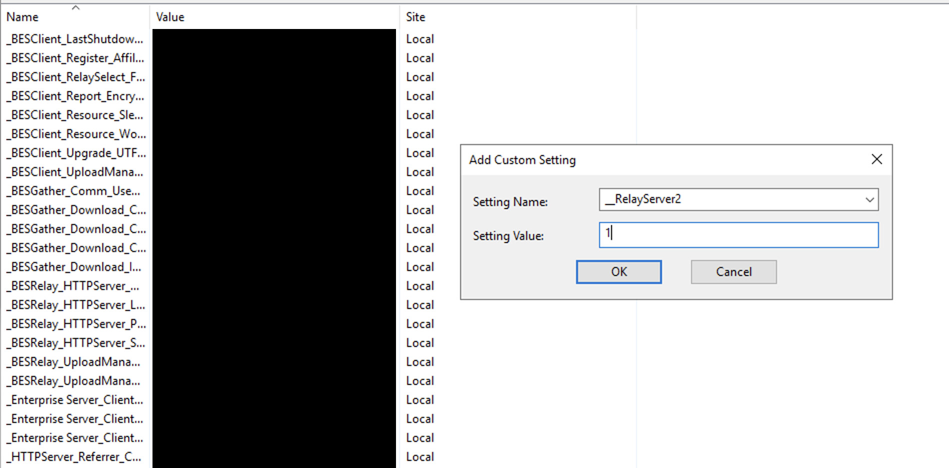

In order for the failover process to successfully occur set the DSA server as the secondary relay in client settings using __RelayServer2 for the top-level relays (or via the console Computer right-click settings user interface).

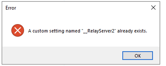

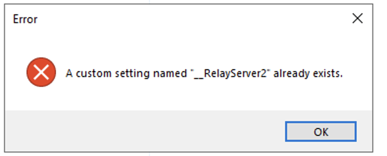

When I did that on my secondary server I get an error message that custom setting already exist.
I look in the dropdown list for the add custom setting and I do not see it anywhere. Where else can this setting be?

NVM I have found it in the registry setting and add value of 1 to _relayserver2. for whatever odds reason it is not showing the list I mentioned above.
This setting (__RelayServer2) is essentially the Secondary Relay, so, rather than appear as a Custom Setting, it should be in the section above for Relay assignment.
So is the value of 1 correct? or it has to be the host name of my secondary server? also I’m doing this in my DSA server not the relay?
You do not need to configure any failover settings on either the BigFix Master (Primary or Secondary). However, your DSA must have a host file entry of the primary server against the FQDN of your BigFix infrastructure.
