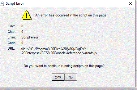

Anyone seen this error? It’s preventing me from creating fixlets with the Software Distribution Wizard.
bigfix error
Any more details to share here? At one point are you seeing this error? On initial load of the Wizard, or after a certain step (if so, which step? it would be helpful to try to isolate and/or reproduce the issue) ?
Is this for the ‘Windows Software Distribution Wizard’ in BES Support? If so, do you have the latest version of the site (currently 1481)?
It happens near the final step, when the progress bar goes across the screen to complete the creation process. It goes green to about 50% completion and then throws the error message.
Yes, I’m using the software distribution Wizard in the Bigfix console.
Do you have all the required Visual C++ runtimes installed on your console computer?
