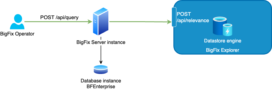

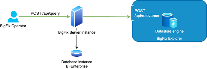

The count attribute was introduced with BES Explorer as an enhancement. And yes, calls to /api/query on the Root Server are forwarded and handled by BigFix Explorer if one is available (and if one is not available, Root Server will evaluate, in which case the results should still of course be accurate):
Note that you can have multiple instances of BigFix Explorer for a given Root Server to help with high availability.
