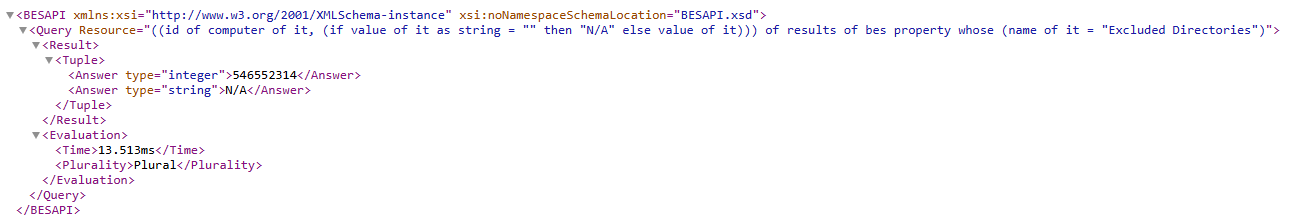

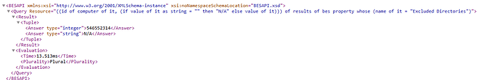

I updated the relevance to target the correct property, and the following version is working for me:
((id of computer of it, (if value of it as string = "" then "N/A" else value of it))) of results of bes property whose (name of it = "Excluded Directories")
This is what I see:
