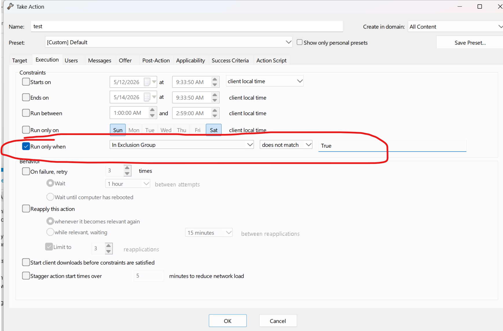

For this use case, I'd probably use Custom Constraints. This is how we implement Maintenance Windows, under the hood.
First you create a Global Property with a name like "In Exclusion Group". For the Relevance of that property I'd probably go with a simple client setting like
exists setting "exclusion_group" whose (value of it as string = "1") of client
When you take the Action, you populate that in the 'Run Only When' field, so that the action only runs where this value is not True:
Then your delegated admins can add or remove their machines from the exclusion group by applying the client setting. They can even apply it at installation time using a clientsettings.cfg so machines get installed with the Exclusion by default.

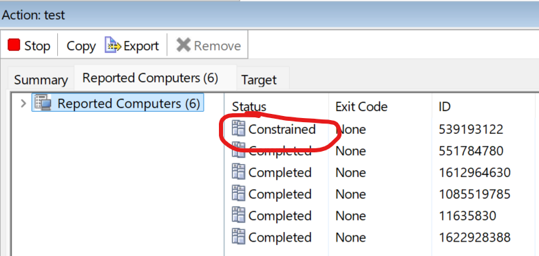

This 'run only when' sets up a Constraint which is also a relevance evaluation. This is a second evaluation that only happens while the action itself is relevant. If the Constraint is not satisfied (this client is Excluded), the Action Status becomes 'Constrained' instead of Not Relevant, which is usually more helpful in my opinion; it helps distinguish between machines that are already fixed/upgraded, versus those that are still in the queue but excluded for now.
Constraint Relevance also evaluates much more frequently than normal fixlet background evaluation, so when you switch a machine from Excluded to Not Excluded, the action usually picks up and runs much sooner than if we were changing a normal relevance evaluation result.
