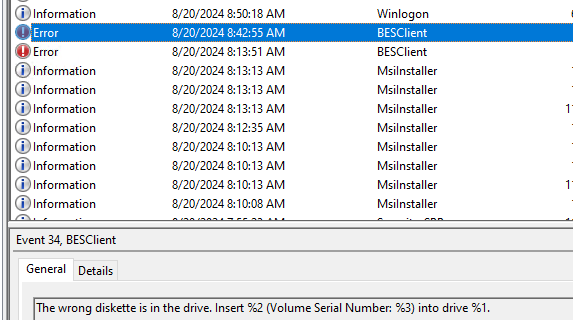

BESClient service stopping with Event ID 34-"wrong diskette in disk drive" error
We have some Windows 2022 servers that have been running updates fine through patch policies, etc. This month we had a small percentage that had an error where the BESClient service stops and will not stay running for more than a couple of minutes. We also noticed that new servers getting built are also having this same error. Any ideas?
Event ID 34
The wrong diskette is in the drive. Insert %2 (Volume Serial Number %3)into drive %1
BES Client 10.0.9.21 on Server 2022

I do not have those credentials to test with, and guessing I will need one of our BigFix admins to perform this step. Let me know if that is incorrect, or if there is anything else I can attempt on my side.
Yes, you’ll need your BigFix admins to verify your client has the right password to connect to their Authenticating Relay.
One last thing you could test from ‘curl’ is to try to retrieve a valid page from the relay, i.e.
curl http://your-relay.example.com:52311/cgi-bin/bfenterprise/clientregister.exe?RequestType=Version
With a non-authenticating relay, this would retrieve the deployment’s version number. On an Authenticating Relay you should receive an error 403:Unauthorized
Thanks for the reply - The curl appears to be working and I will check the rest with our BigFix Admins.
curl -k https://bigfixrelay3.<redacted>.com:52311/cgi-bin/bfenterprise/clientregister.exe?RequestType=Version
ClientRegister
Version 11.0.1.104
This ended up being some regkeys that needed changing, if anyone else ever has this issue
hklm\software\wow6432node\BigFix\EnterpriseClient\Settings\Client
change RelaySelect_Automatic=1
delete INTENTIONAL_MANUAL_RELAY
change bigfixrelay.<redacted1>.com to alpha.<redacted2>.com
