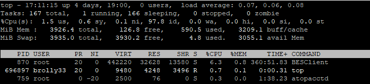

top
Should show BESClient somewhere in the list.

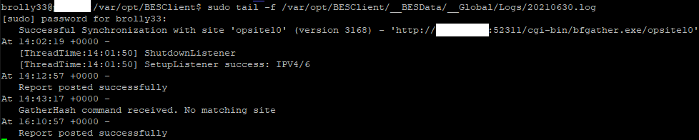

You can also check for today’s client log with a sudo (since the __Data folder is permissioned against your access)
sudo tail -f /var/opt/BESClient/__BESData/__Global/Logs/20210630.log
