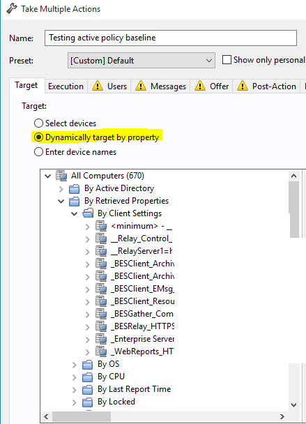

-I’m fine with the software deployment portion, building the fixlets to do that etc. When I start an action on the fixlet I want to automatically apply to a computer with that HomeOffice tag, I select ‘Dynamically target by property’, I don’t see a way to drill down and specify the client setting tag. The screenshot on the wiki doesn’t really help, and I’ve dug through all of the options without success.

I think they may be looking for you to expand out All Computers:
The “By Retrieved Properties” part uses the columns you have showing in your console. You can simply make an analysis that pulls this client tag and add the property as a column in your console, and then target machines with that tag through By Retrieved Property.

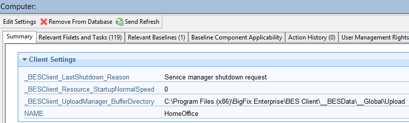

I imaged a test machine with the new bare metal profile that sets the client setting. It shows up in client settings as NAME with the value of HomeOffice.
I haven’t written relevance that looks for details of this area before. I’m setting up the analysis to look for this setting now, how would I write the relevance for it?
That is because of this:
If you change “NAME” to something else, that will be the client setting name. So you could do Location:HomeOffice
If you changed the name to Location, your property would then be:
value of setting "Location" of client
Client settings are definitely pulled already (so the Console can display them when you edit the settings) through the property “Client Settings” so you’d have to go into that property section for settings

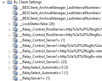

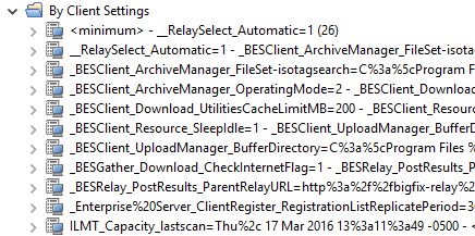

Right – if you add the, “Client Settings” column you can get it but you have to change the range settings.
Otherwise it looks like this (it groups them into ranges of values for some reason):
Right click on, “By Client Settings” and change the values higher:
Then you can see:

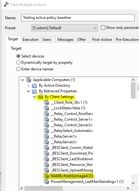

randomly, while testing something along the same lines, trying to target the custom client setting (I do plan on renaming it for better organization … just don’t want to rewrite things at the moment)… it’s showing up if my target is under select devices like:

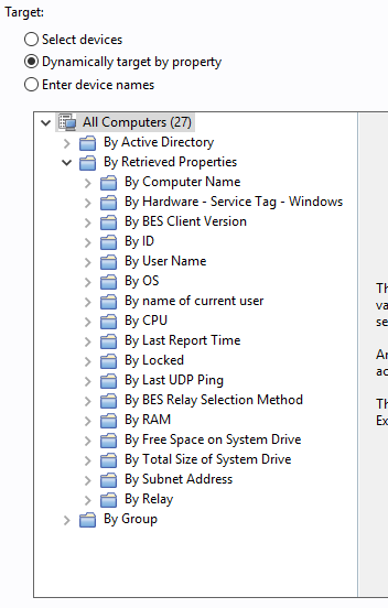

however, that isn’t what I’m after, I want it to dynamically target by property … it doesn’t show up there, any idea why? it used to! :slight_smile:
if I drill down further from there and go through all of sub folders, under _webreports …
it shows up here. but I have to imagine that is a really poor way to target this.
I think it’s because you’re using the global “Client Settings” Property - which has, as its values, both the name and the value of every setting on the client. When you are viewing it by “Select Devices”, you’re only seeing the values that are present on clients that have reported Relevant for this fixlet. So breaking it up by ranges allows each value to be shown. When you target Dynamically, you will be filtering on every client setting on every machine - even the non-relevant ones - so there are too many to list individually. Instead they’re listed by ranges.
See how the first one lists "<minimum> -- __something"? That means you can expand it and see all the values between.
But that’s not what you want to do. What you need is to add a Column to your computer view, find “NAME” (which, btw, is a badly-named client setting!), and then that will show up in the target as its own property. So your view would show “By OS”, “By CPU”, “By Last Report Time”, “By Locked”, and “By Name”, along with whatever other columns you’re displaying.
In short, you don’t want a column that shows every client setting - you want a column that shows just the one client setting that you’re trying to target.
