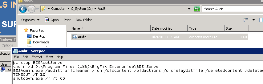

I’m able to copy the Audit.bat file inside folder C:\Audit.
Concern here is when I execute Audit.bat file through BigFix Task first line of the batch file is working and it is stopping root server service and after that remaining lines are not getting executed but when I execute same using Fixlet debugger everything seems to be working fine without any hassle.
Batch file content
Comment :- Through BigFix Task only first line is getting executed and remaining line is not getting executed but using Fixlet debugger every line is getting executed successfully.
sc stop BESRootServer
chdir /d D:\Program Files (x86)\BigFix Enterprise\BES Server
BESAdmin.exe /audittrailcleaner /run /oldcontent /oldactions /oldrelaydatfile /deletedcontent /deletedactions /orphanedsubactions /hiddenactions=15 /deletedmailbox /syncconsoles /olderthan=15 /batchsize=100000
TIMEOUT /T 10
shutdown.exe /r /t 00
